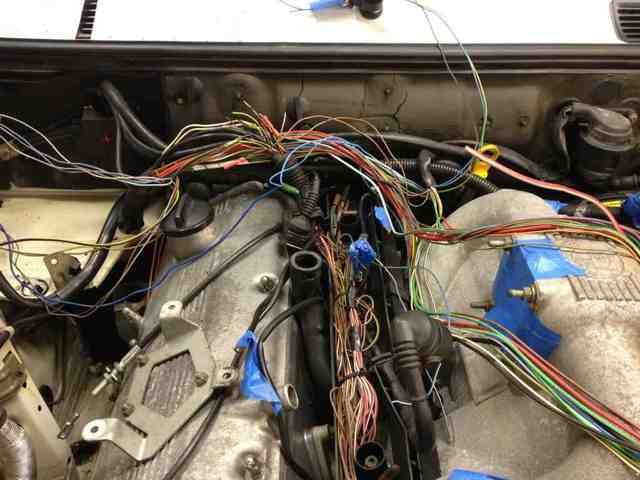

Was that post aimed at me, or another Luke? Anyway - yes solder your engine loom, don't use crimp on connectors for something as important as your engine loom for reliability.
If you use an M20 loom and unwrap it, there are only a couple of injector wires to lengthen and the alternator exciter wire. Everything else can just be re-routed and rewrapped.
Wiring is fun :)
