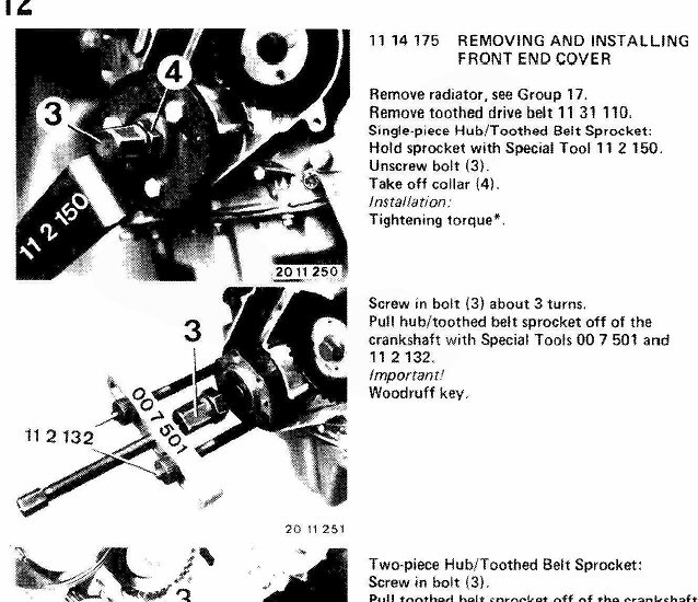

How do you do this? The shop manual suggests a special tool, must i actually have to order this from bmw?
Removing hub/toothed belt sprocket from crank

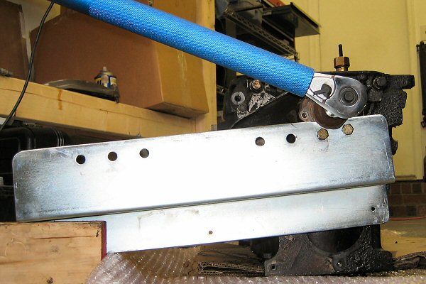

to clarify, the item that needs to come off is the hub where the 13mm bolts screw into. attached to that hub is the crank's sprocket where the timing belt runs around. its diameter is too large to remove that last dust cover...Originally posted by rs4pro3just removed the 13mm headed bolts holding it on, and then pull it off, a rubber mallet comes in handy to tap on it a tad.Comment
