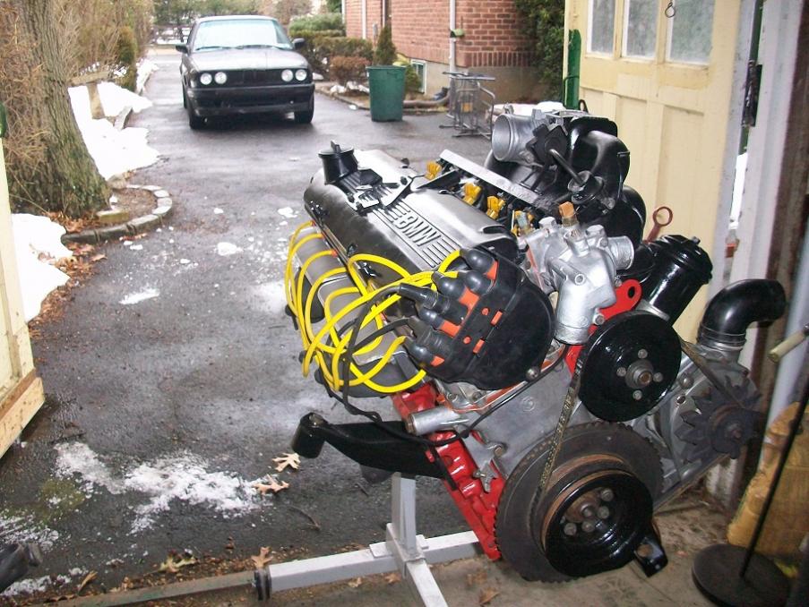

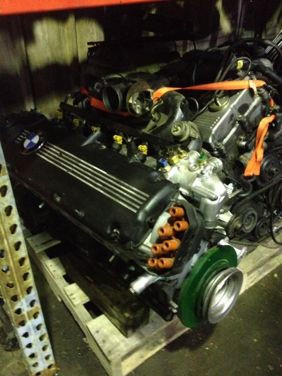

              I think the easiest way to tell is the presence of a crank position sensor and crank pulley that is notched all around the bottom. That signifies Motronic 1.3 which is a b35. A less reliable way to tell is the 3.5 on the intake manifold as opposed to the 3.2/3.5 on the b34. Plus the valve cover on the b35 has no BMW logo and just the letters BMW on it.
              b34
              b35

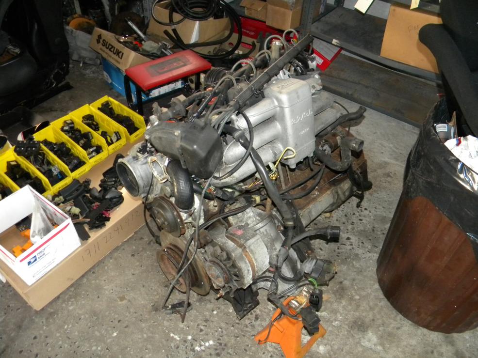

                Ok cool. I got one picture of it right now, I'll have to check it out.
                Also when I do the swap will my OBC still work right? What kind of gas mileage can you get out of the m30? Is it about the same as the m20?
                Here the one picture I have of the engine

                  That's a b34. I would pass personally. I picked up a complete 735iL for $200.
                  To me, if you get to go m30, you might as well get the very best version you can get.
                  The one plus to the b34 is it is safer to boost than the b35. Stronger block and lowest factory compression.
