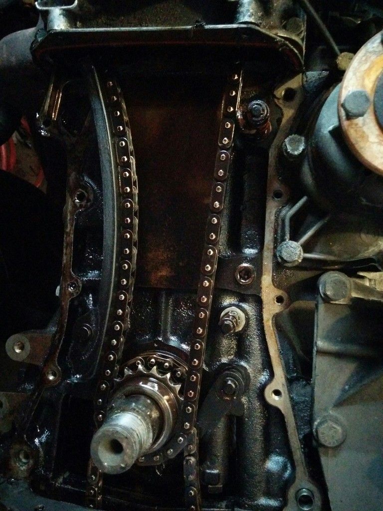

    New chain stuff.
    From the old motor.
    Yeah, it was loud.

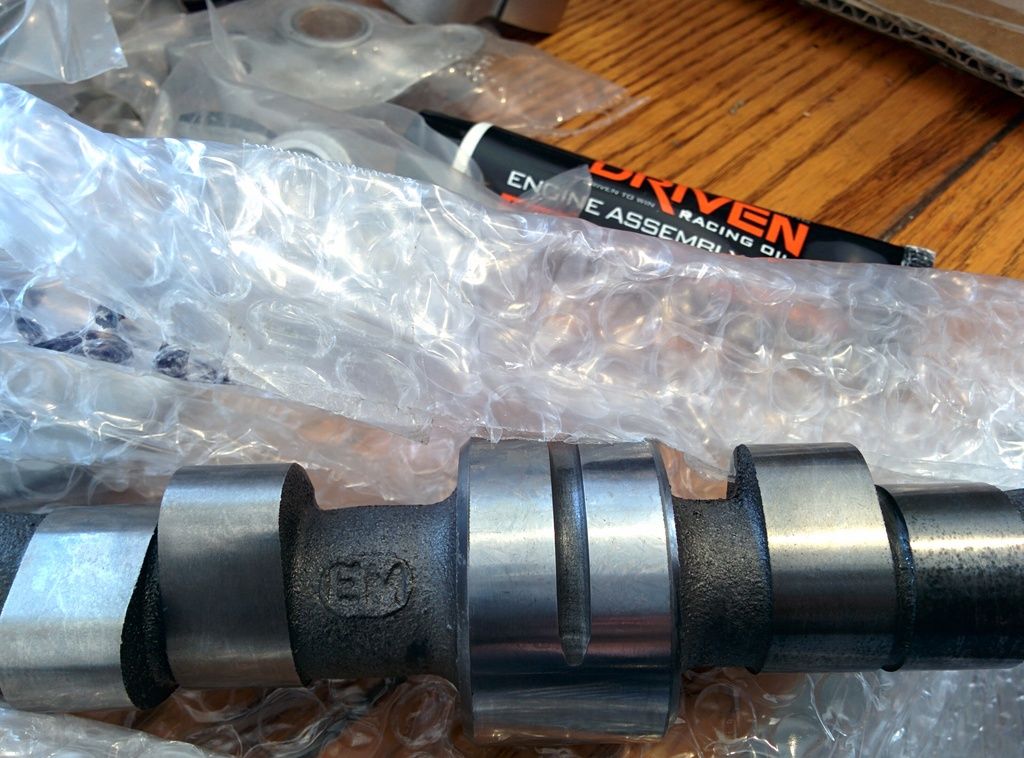

      new rag
      $200 for the head rebuilt with a "turbo" cat cam from vac and IE rockers 3 angle grind.

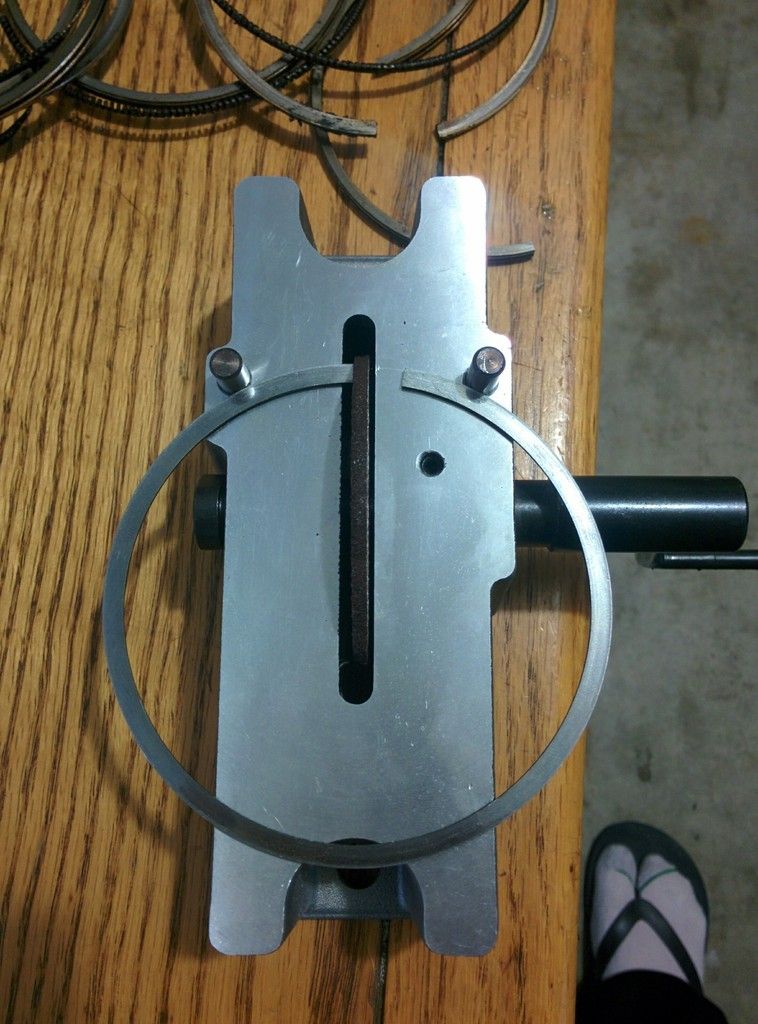

                  Here's some more pictures how I did the rings.
                  Stock size of left. I kept it stock size for the middle ring but I measered
                  a stock block and it comes out to 0.030 no 0.027. What do you think?
                  Copper spray everything.( ͡° ͜ʖ ͡°)
                  • ak-
                    • 12422
                    Ring gap on turbo motors will forever confuse me.
