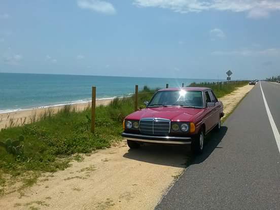

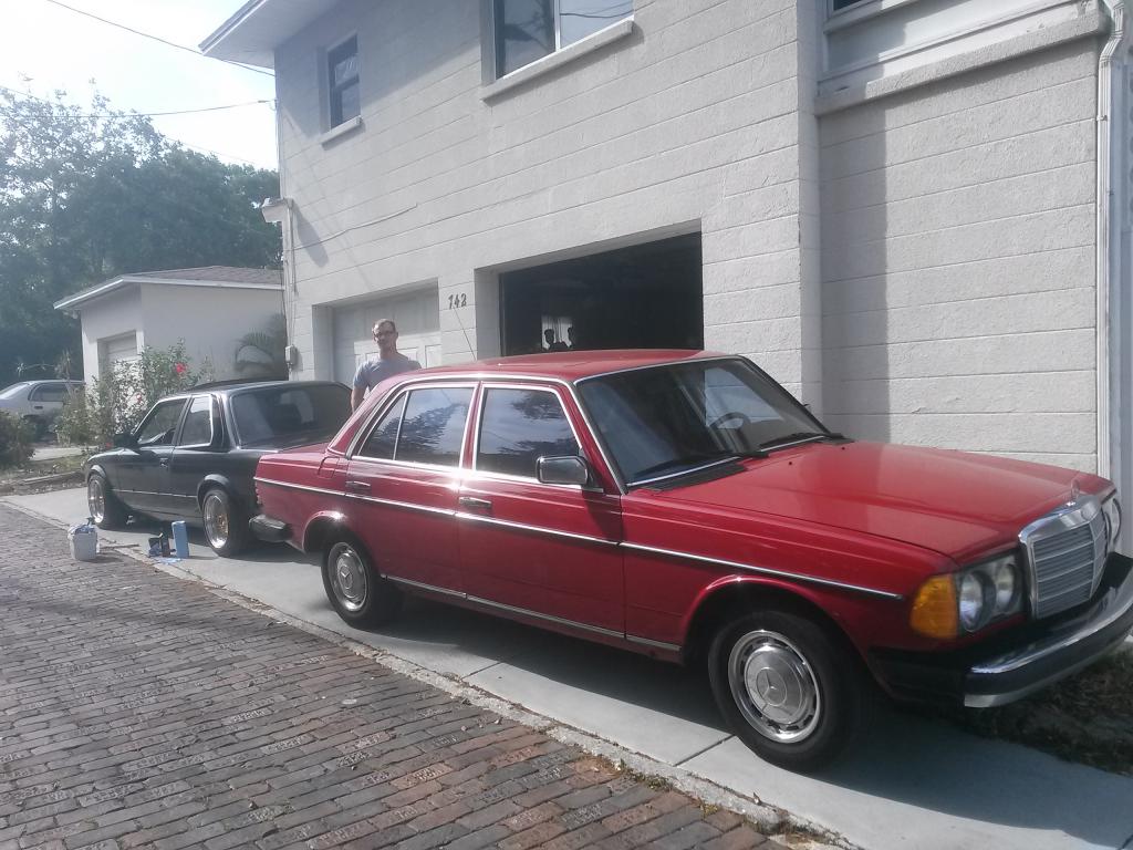

        Some pics of my w123 and my 87 E30 M60B40. I'll start looking for an M30 at the local junkyards next week, and post my findings and prices.
