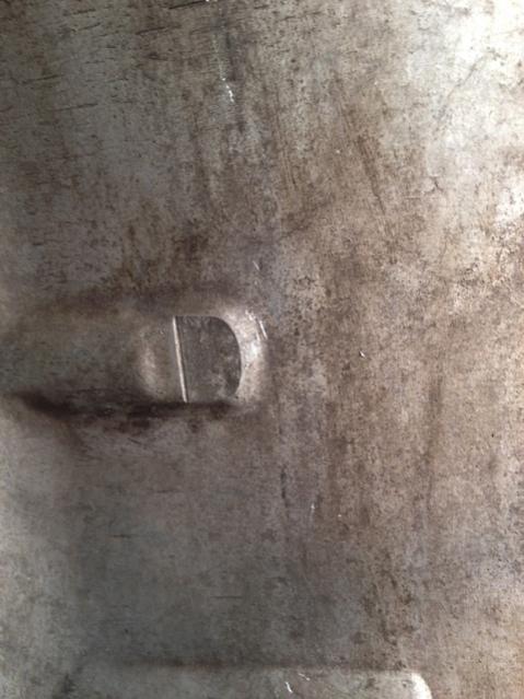

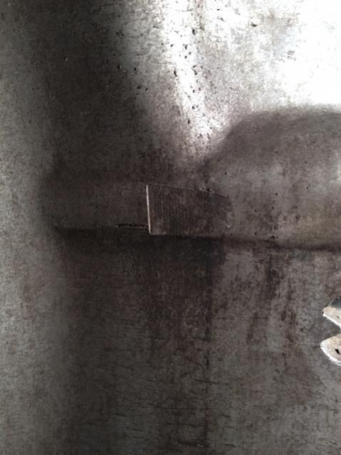

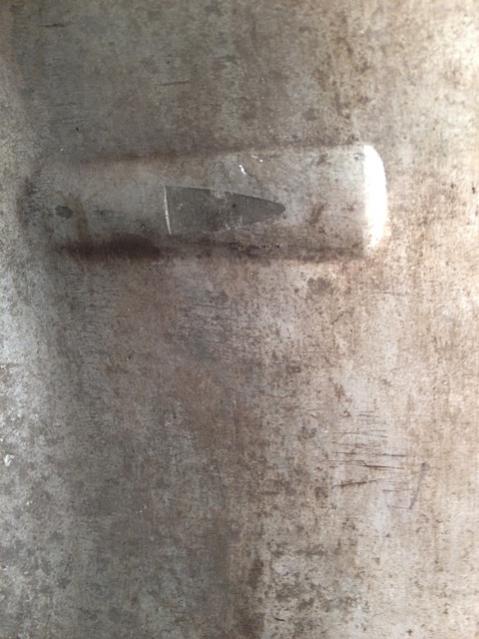

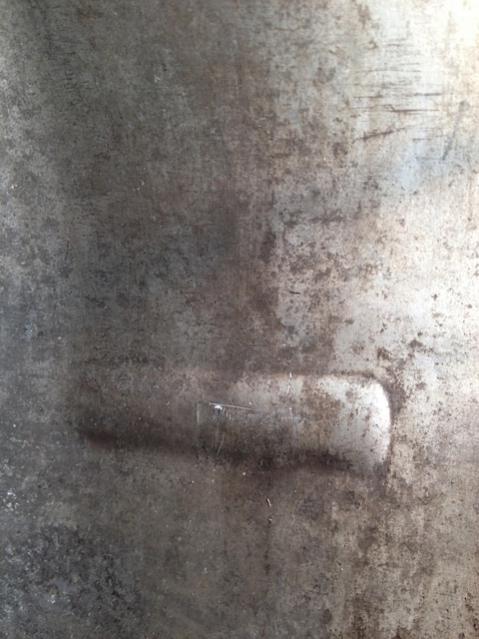

                  So while hunting for a the elusive replacement 260, we decided to pull the tranny anyway.
                  What we found were score marks on 3 of the 8 raised nubbies on the inside of the bell housing and burnish marks on the outside edge of the clutch pressure plate.
                  So we now think it might be that the Dual Mass (DM) that is starting to go or is out of wack.
                  So now also hunting for a single mass flywheel to see if the DM is our culprit. Fingers crossed
