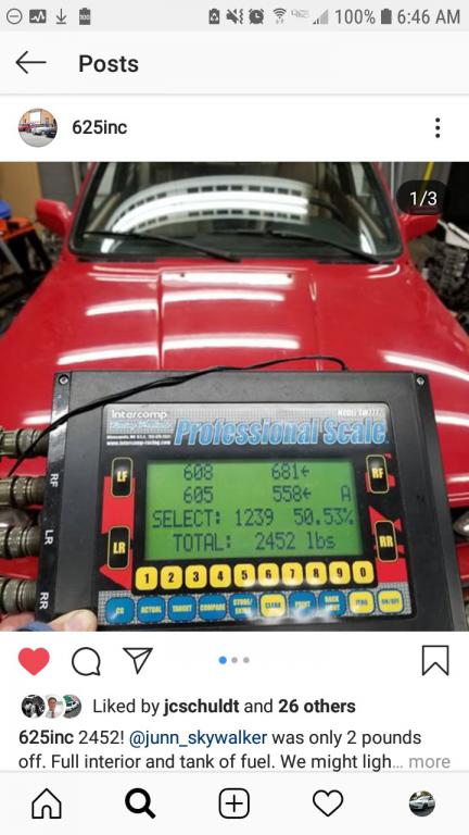

    full tank of gas, full interior, and complete exhaust

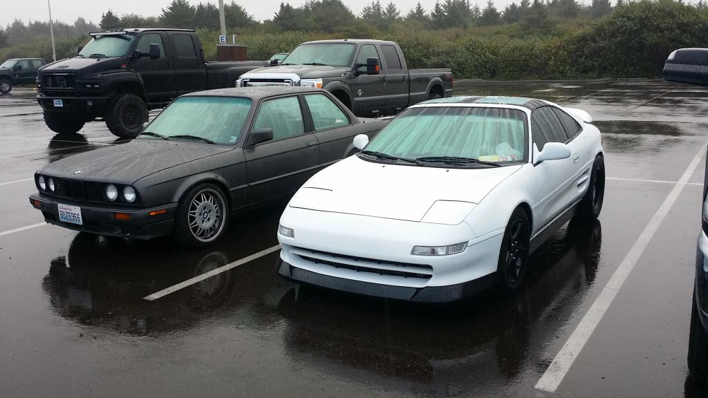

            I've got a K24A2 turbo swapped into my MR2, the GF's E30 has an iS engine swapped into it, but even then that's getting tired...I'd love to be able to swap the same engine and turbo setup into her car!!
              Originally posted by m5james View Post
              I've got a K24A2 turbo swapped into my MR2...
              Do you have a build thread anywhere for your MR2?
                I don't :/ Just tons of pics and it's still a work in progress. It's pushing 424hp to the wheels in a vehicle w/ a similar weight to an E30...it's a bit scary without an LSD and working ABS, yet that's not stopping me proceeding with upgrading the headers and turbo so I can get it tuned for E85 :-) I plan on installing my old header/turbo setup onto her car once I get her K swap installed and running.
