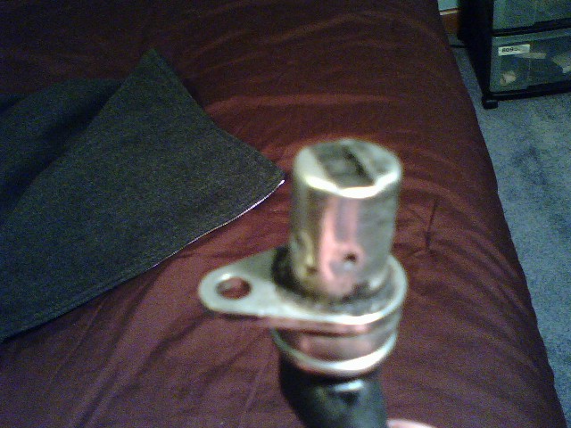

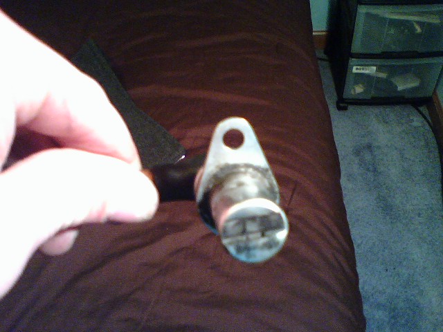

      • Garageaholic
        Freestyle Fabricator
        • Dec 2005
        • 5204
        Time for a new sensor...
        Here are some pics (from my phone) of my reference sensor. I'd say that the groove is at least 1/32" deep. It's made it's way through the actual inductor inside the sensor. Take a look. i definitely need a new one.

        • george graves
          • 20003
          that sensor is REALLY sensitive - the wires are brittle - and dropping it can break it. New might be pricy - try a good used one...
