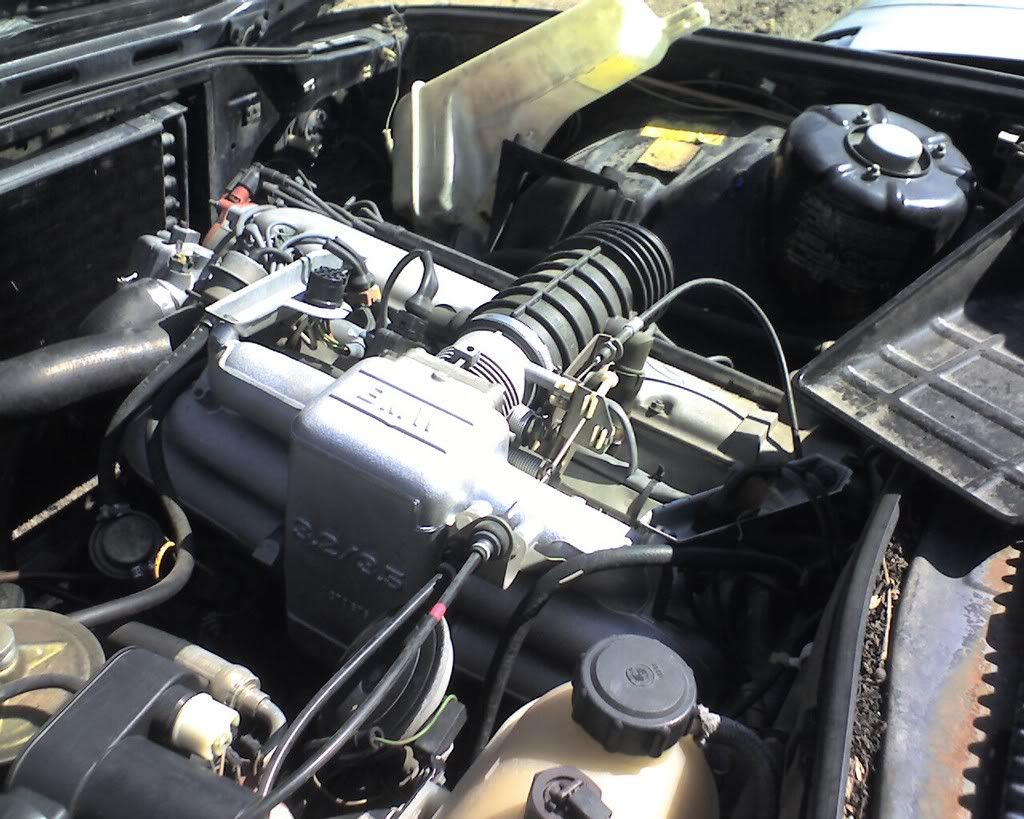

    i found this on a 735 at a yard they want $150 for the engine. is it a good project? or just stick to an m20 stroked?. Also what engine model is this?
    any thoughts, pointers, links... appreciated :D

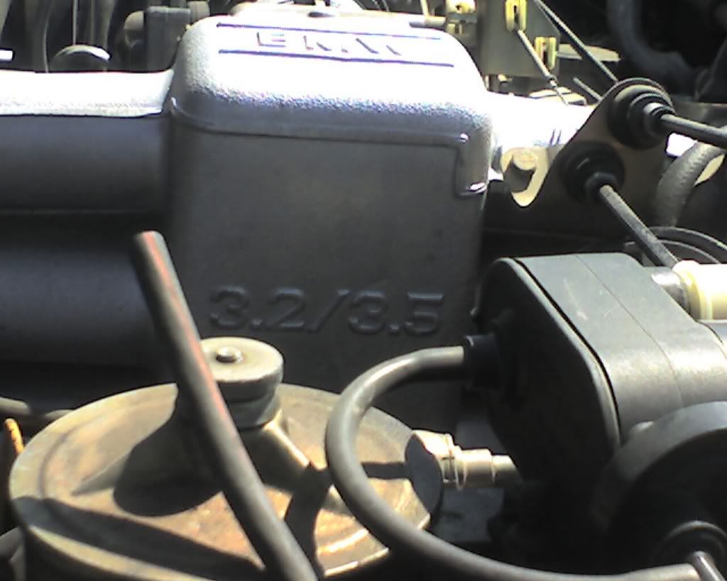

      I'm going to say that is a m30 from an e23 7 series...I'm gonna guess its a 3.5L..im not sure if the 3.3s had 3.2/3.5 stamped on the intake manifold.. my m30 is out of a late model e23 *03/87 production so its a genuine 3.5L... that motor w/o a cat, chip, decent exhaust should get you around 200hp/240ftlbs at the crank...that will make your e30 on par w e36 Ms and maybe an e30 w the s50 swap
