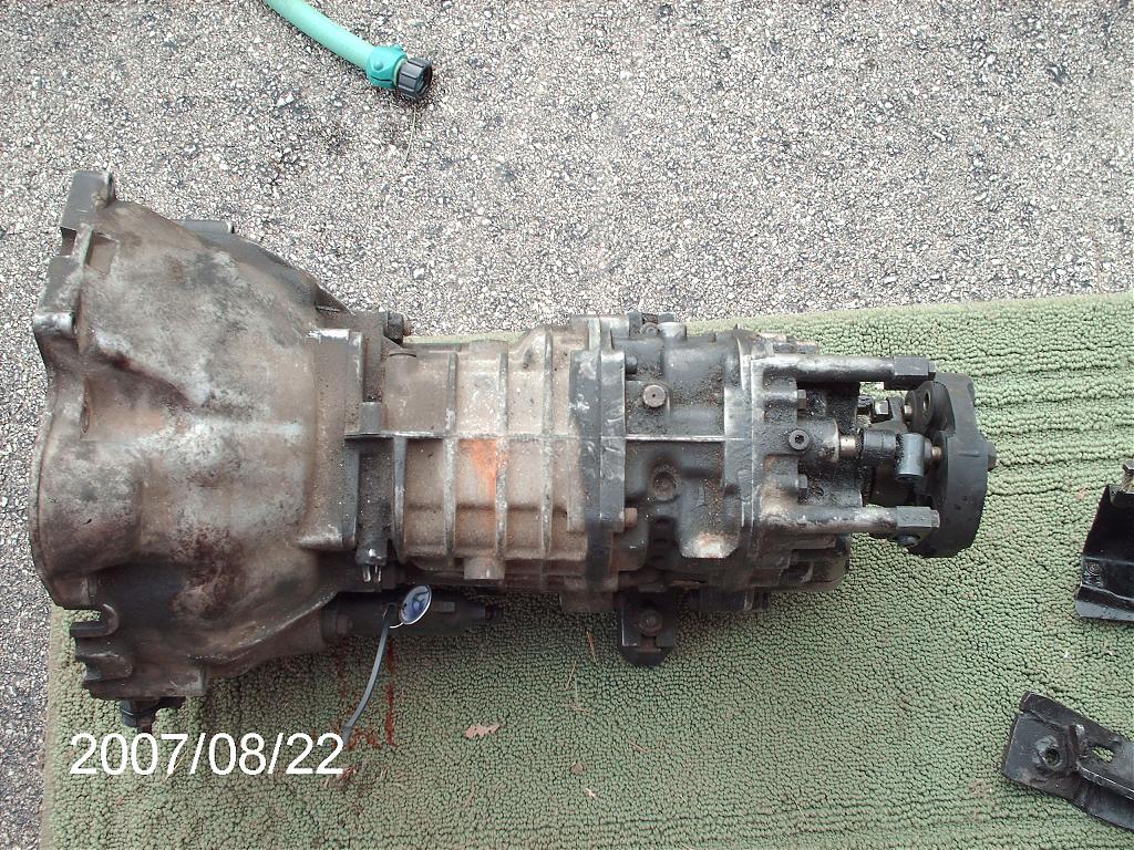

    Now on to the transmission. I have the transmission pictured below will this still fit good on the above motor? What will I have to change (exhaust, radiator hosing) from the 3.2/3.5 setup?

    That appears to be a 265, unless it's the super rare 262 dogleg
    Yes, it will fit any M30 and should not have any adverse effects on the exhaust or any other part of the build, except the driveshaft... With my 265 I had to have the driveshaft shortened by about 1 3/16".
    Having an oil return fitting on the block will not cause any issues unless it is open. As long as it's sealed shut it will be fine.

      Well, the driveshaft is already adapted to the tranny/motor. So will this above motor be longer in any way that will affect the driveshaft that already was in the swap?

        As long as it's an M30, the length will be the same, so nothing should change at all.
