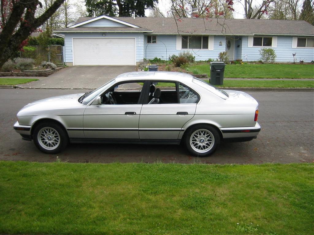

          A blown knee and arthritic ankle make driving the 5 speed problematic. Getting old. It is a hoot to drive, though. I will sell the car in the near future and the 6 coupe as well. I bought an E34 535i as a daily driver to replace the aging 633. I may add a TCD kit to the 535 and make it a play car as well.
