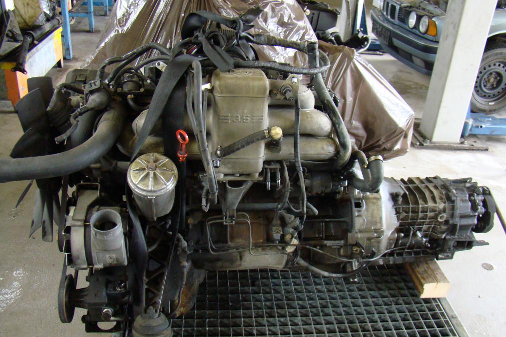

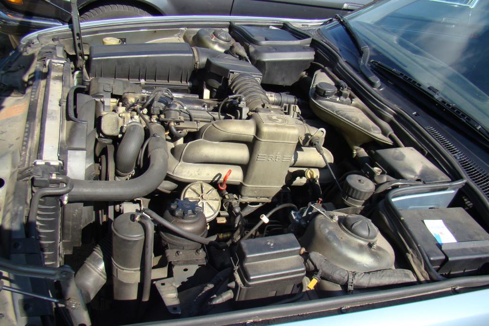

              yes it's possible but it's a pain in the ass!!! but if you want take the exhaust down, at least from the downpipes back, take the dirt shield off, take loose the drive shaft carrier bearing, take loose the tranny mount from the body.....then to get to the tricky bolts on the top of the tranny you will need an extension about as long as the distance from the head of the bolt to the ouput shaft on the tranny.....pull down on back of tranny and fight with socket until it sits COMPLETELY on the bolt you break loose those top bolts....the others are easy.....it's almost easier just to pull the motor and tranny and then go to work
ID:	7107301 not so easy
