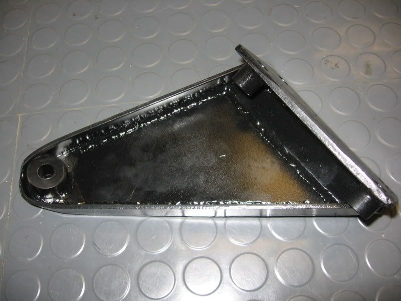

      I was going to try and use the stock brace or just order 1 for an e30 M3.. if neither of those work I have access to virtually every bmw part they still make so Ill just find one and order it. here are a few pics of my mounts
      sorry not the best pics, I used the work camera up here. I talked to the guy that made my mounts and he wouldn't have a problem making some more for me if I generate enough interest..him and I were thinking maybe 3-4 ppl interested in them would be worth his time. The holes for the bolts were the most difficult part of making the mounts he said but as u see he got them done and they are pretty nice. They are made from steel, not aluminum and he painted them for me.
      correction.. these are steel, pretty light but has a solid feel to them.
