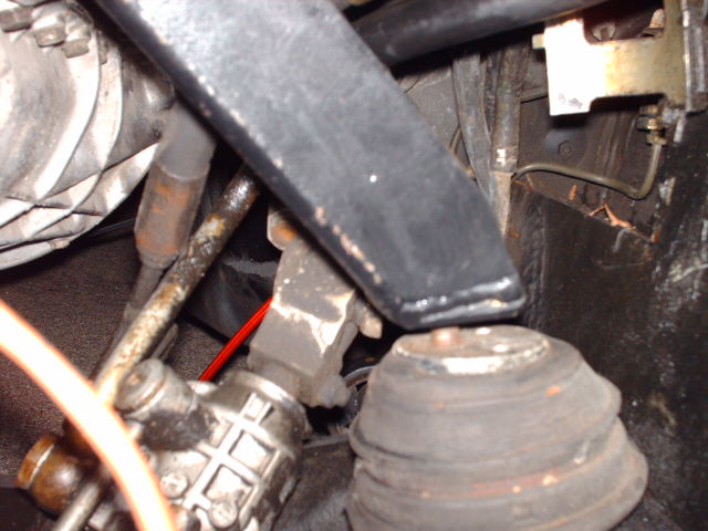

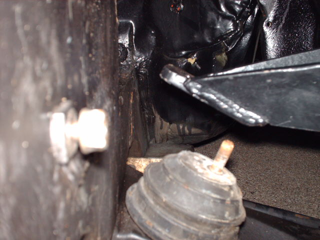

    I have a pair of funkmasta's mounts and I am installing at the moment.
    I have one that goes completely in but the other is to the passenger side too much. The holes line up but the it wont go back far enough.
    Any suggestions??

      First thing I see is the rubber mounts look kinda thrashed, and what are they off of? They don't look like M20 mounts. The studs don't seem to be centered in the mount.
      Also, once when I was dropping in my M20, I engaged the stud on the drivers side first and then found the same situation, the passenger side was too far over and would not drop down. I pulled the engine back up and started the passenger side first, and the drivers side went much easier.
      HTH.

            Check to see if the transmission is hanging up on something, that's the first place I'd look. It looks like you have the correct oil pan and whatnot, so just take your time, double check everything, and keep trying. Check the back of the cylinder head too, the B34 has a little water manifold on the back that can get caught on the firewall.
              Your biggest help will be to get a friend to regulate the hoist, and a manly prybar (at least 24", 36 or 48 is better).
