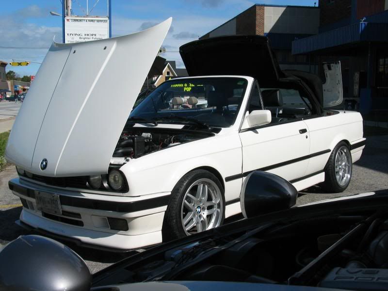

                    Hi there,
                    Congratulations on the cleanest, best factory looking M30 swap I ever saw...
                    couple of questions here,
                    1- What driveshaft did you use ? did you have to shorten and balance one ??
                    2- About exhaust manifold and downpipe ? could you use the E34 one or did you have to use a custom one ??
                    3- Is your engine position 2 or 3 ??
                    4- About ECU, since the E34 use Motronic, did you use the ECU and full harness from the E34 ?
                    5- Your sig mentions an E.A.T chip, do you fell the difference ? what BHP you reckon you have ? Is that a great improvement ??
                    Very glad if you could help to answer those questiosn.
                    Regards from France / Pierre

                        Thanks for comments... not sure I'm deserving of cleanest swap, but it's appreciated.
                        What tranny mount did you use?
                        E30 crossmember with ireland engineering urethane mounts
                        325e front 1/2, 325i back 1/2. Had to play with length a little bit but nothing serious. Did not balance it. No vibrations up to 100mph.
                        I used an E34 manifold set and E34 downpipes but had to separate the pipes to get them to fit properly. Put O2 sensor bung into downpipe as well.
                        There was a problem getting the downpipes to fit around the E30.de style mount bracket. There are several E34 styles of exhaust downpipes, the one I had on hand was one of the only ones that doesn't work well. I think it was identified by having a sleeve over it IIRC (not sure).
                        Engine is in position III
                        Yes, ECU from E34 and full harness. Minor mods required to get tachometer, fuel economy, and power windows to work correctly.
                        Yes you feel the difference. Can't comment on BHP as I haven't done a before and after comparison. However I've had an EAT chip in my E34 535 5 speed for years and swapped it into this setup. Highly recommended.

                                The motor looks SOOO far foward is it just the pictures fooling me?
