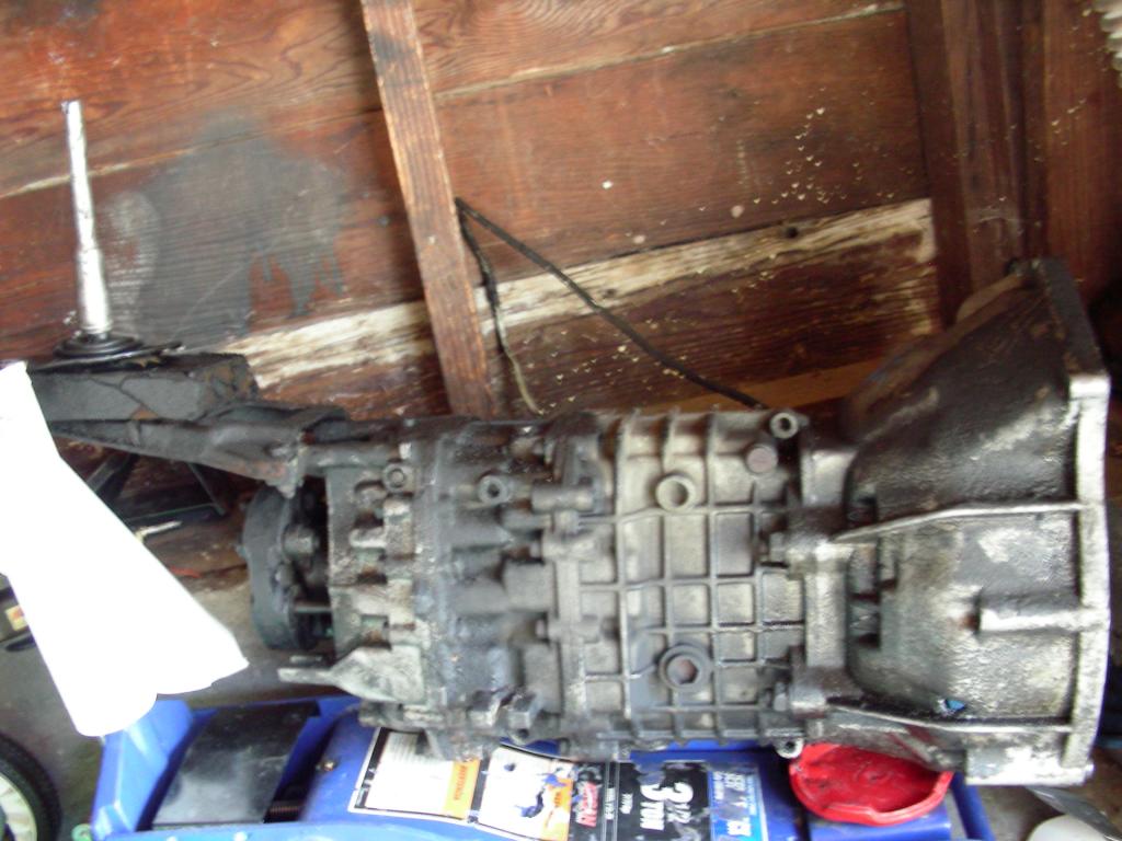

          If it is in fact the 260/5, it's is a decent transmission but is not as sturdy as the later 260/6 or the 265. Though... I'm not 100% sure the E23 ever came with the 260/5 since they were the largest BMWs of the era. Does the transmission have a removable bellhousing or is it a single piece? If the bellhousing can be removed, it's a 265 and you should snatch it up. If the bellhousing is a part of the transmission it's most likely the 260/5 and I would pass or at least talk him down a bit. Flywheels are cheap and very common, so I'd only consider that to be worth $25 to $50.
          Even if it is a 260/5 it will bolt right up to your B35, and like the others said, you won't need the reference sensors if you use the B35 electronics. The driveshaft is an unknown here since the length of the 260/5 is different than the 260/6 and 265 (these two are the same length I believe), so you might have to have your driveshaft shortened or lengthened.
          Here's a quick visual of my 262CR which is the same housing as a 265. If the tranny has a removable bellhousing like this, it is worth every red cent. By the way, I think the rear portion of my case has magnesium or something in it, it's very oddly colored. My 265 didn't have the same color at all. Weird.

            aha,
            from under car, the tranny looks like yours ( removable bell housing) with that 2 cables.
            Should i ?
            • euroshark
              • Apr 2006
              • 3491
              That's good, it's a 265 and that is just about the best transmission to use for this swap. I'd snatch it up and pay the man!
              • R3V
                • 63
                Wow, thanks for the rapid responses...
                I couldn't see from the top side as its still attach to the car.
                The rear / lower mounting brackets kinda looks different from yours, it has 2 mounting ( 1 on each side, and 1 on the rear bottom of the tranny ) but i'm not sure.
                • R3V
                  • 63
                  It looks like 265, i haven't had a chance to line it up with the B35.
                  What do you think?
                  • euroshark
                    • Apr 2006
                    • 3491
                    Sweet score, that's a great tranny. It will bolt up just fine! Most B35s in E34s and E32s were mated to automatic transmissions so don't forget that you will need to install a pilot bushing in the end of the crank if there isn't one already.

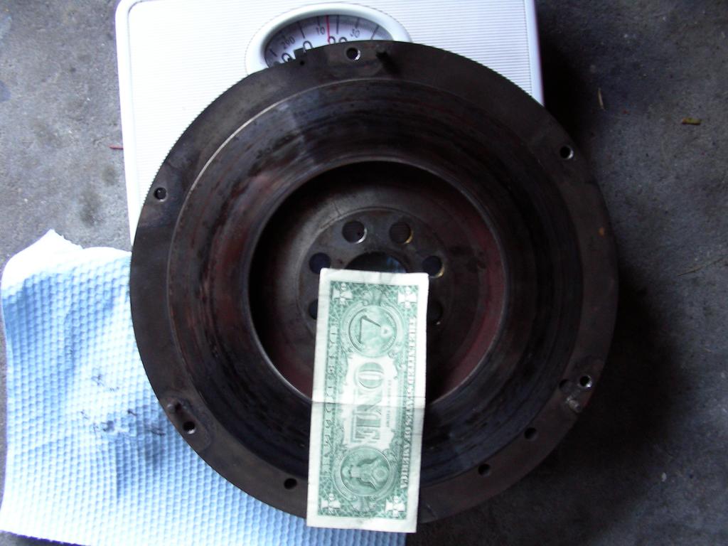

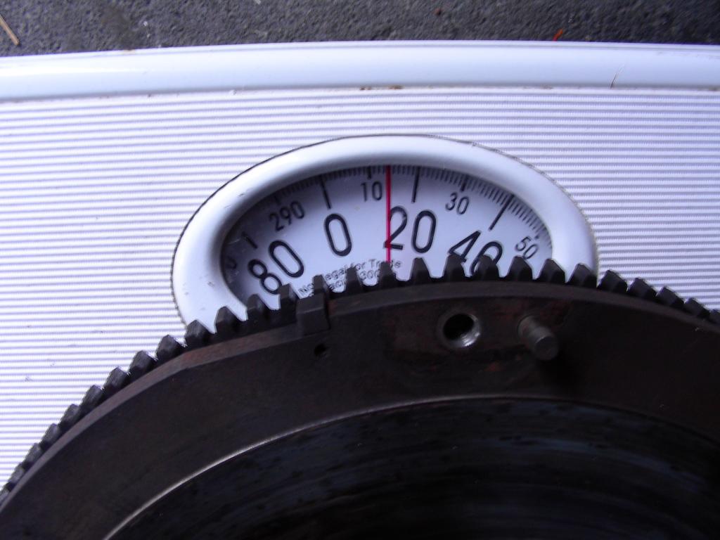

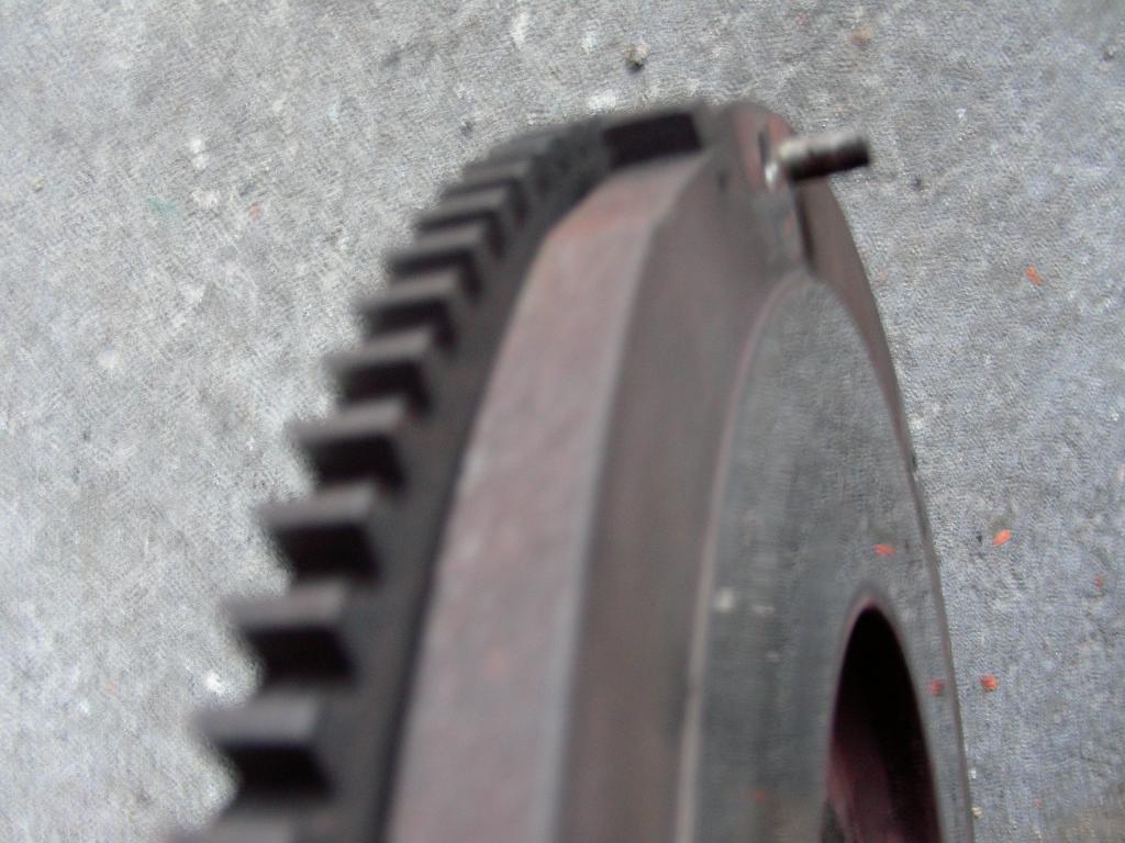

                          • R3V
                            • 63
                            Called bmw dealer, and they said.....$48 !
                            well, a 36mm socket on the front crank nut apparently did the job :)
                            ...finally got the flywheel off.
                            I think it's 11 -12 Lbs ? on a bathroom scale:
