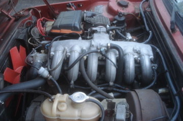

    I maybe be buying an '79 528i soon, and I want the m30 guru's opinion on the old 2.8. I know about the cam oiler issues, and the 2.8 didn't have the earlier 3.0's thermal reactor-induced head crack issues.
    details: L-Jet injection, 4-speed, under 100k, no rust, needs paint and a clutch

    The 2.8 is very sturdy. Like you said, it shouldn't have head issues if it wasn't fitted with the reactors, and the 2.8s also have the advantage of a lot of space between bores so head gaskets tend to last just about forever. The oil spray bar can be easily modified with a bench vise or even vise grips. you flatten out the middle inch or so - but not completely - so that you get better pressure at the holes that generally lack pressure. They issued an updated banjo bolt part number that is supposed to resist backing out, but a little loctite never hurts. Under 100k miles is a lucky find! I wouldn't be wary at all of that engine.
    It's obviously not the most powerful M30 in the lineup, but they actually do pretty well in the E12. L-Jet sometimes feels more responsive than Motronic too, they have a very different feel than the mid '80s US spec B34 powered cars.
    When you get the car pretty you can swap in a euro 3.5 or a B35 pretty easily!
