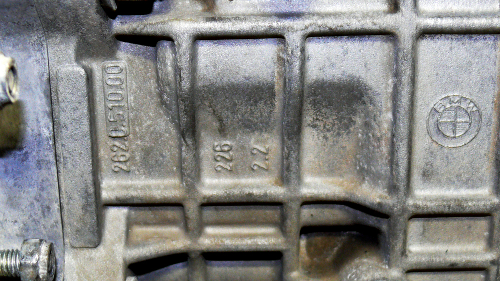

        Here's my 265CR case. As you have read, the 265 uses the 262 case, but 262s are apparently only four speed transmissions. Your number doesn't match mine, but you never know! Check to see if first is down and left.
