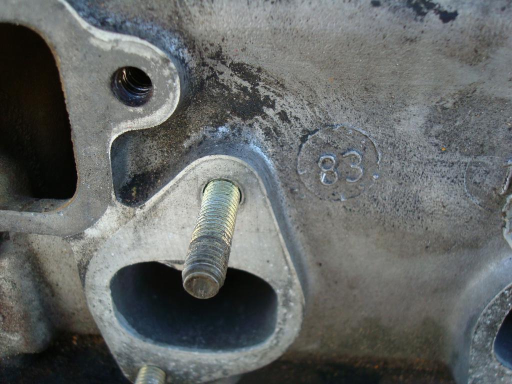

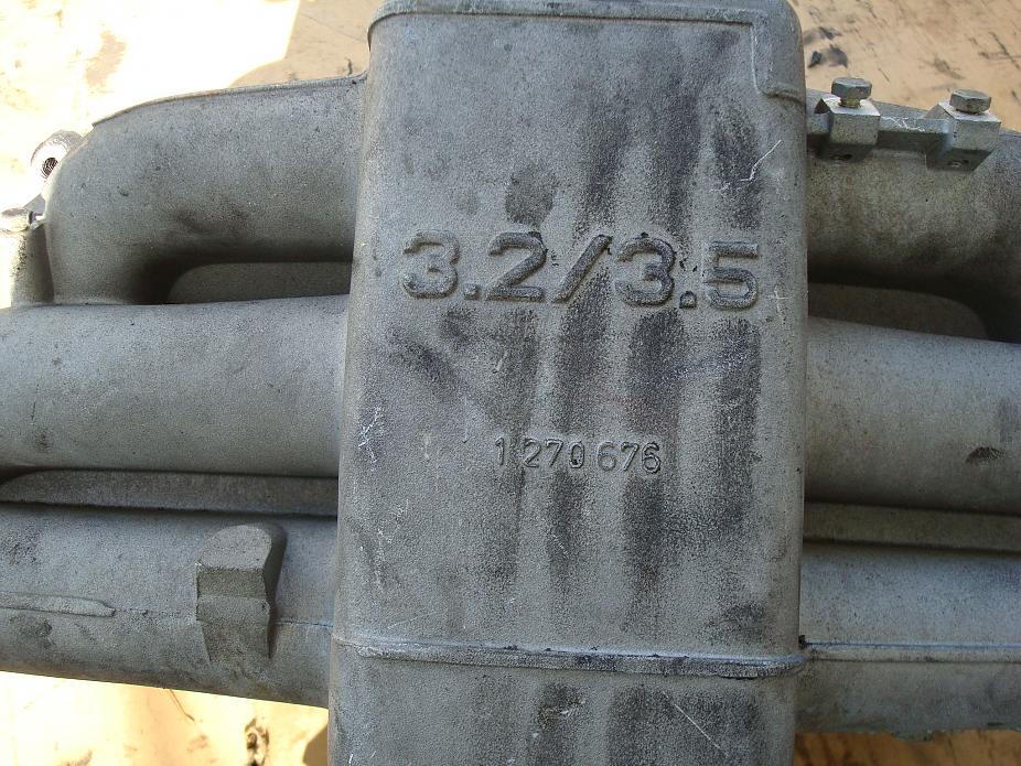

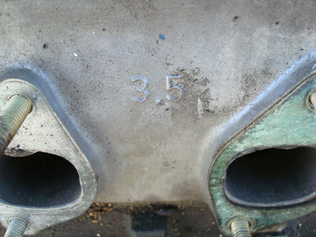

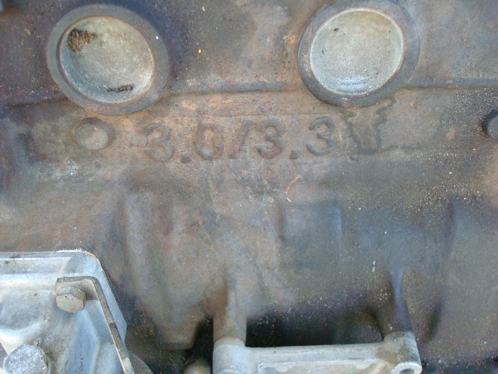

    Here are some pics I just snapped after putting it up on the stand. The manifold is stamped 3.2/3.5, the block is stamped 3.0/3.3, and the head is just stamped 3.5. The head also has an 83 casting year. Is this just a standard 3.3 out of a 633 or has it been messed with?

      What year car did it come out of? The 1984 cars had a hotter cam, higher compression, and a lightweight flywheel on them. Sorry, cant tell you about the block/head, but that is the right manifold.
      Project M42 Turbo
        I believe it is from a 1984 633csi. From what I read, those motors have the same stroke as the 3.5 but different bore. Is this correct? If so, can it be bored out to 92mm or is the casting completely different leaving the water jackets as an issue?
          Same stroke as the b34 (86mm) but the bore is 89mm on the B32 instead of 92 on the B34. Yes, they can be bored but I wouldn't bother personally. Finding a B34 block will be cheaper probably. The block and head combo is correct, there was only one casting for all of the 3.0, 3.2, and 3.4 liter heads from the late '70s to the late '80s when the B35 replaced the B34.
          GearheadE30 is almost correct - US Spec B32s up through 5/84 had a lightweight flywheel and hotter cam, but the compression was the same as the 3.4 at 8:1. the euro B32 had 10:1 compression just like the euro B34 and the power difference was about 18hp. US Spec B32s are rated at 1hp less than a US spec B34 and about 15 to 20ft/lbs less at the peak.
