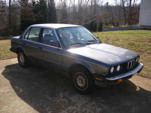

                noobs been there done that... i'll get some more pics tongihtttt
