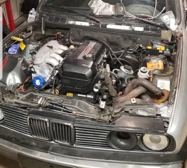

    Started this project October 1st and went for its first drive today! The noises this motor makes are mesmerizing!
    Swap motor mounts are garagistic with Xcessive Manufacturing mounting brackets for trans and motor as well as the driveshaft.

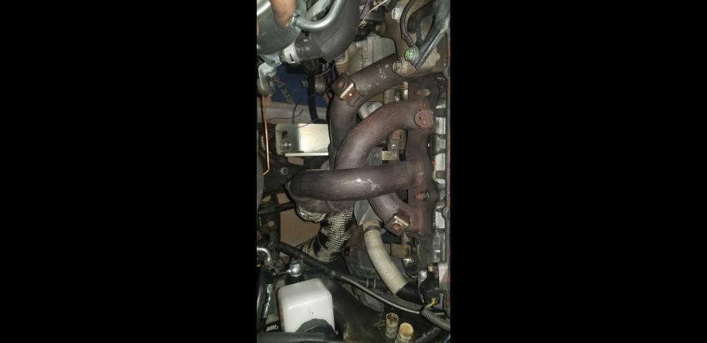

    The manifold was a PITA to modify its way around the steering shaft. after the manifold I have it connected with V band for easy serviceability in the future.

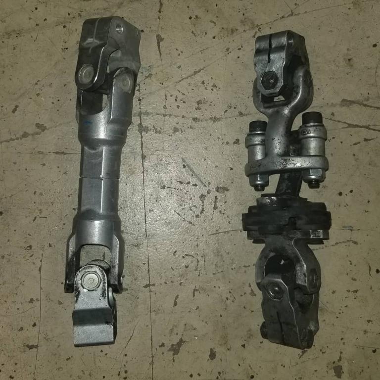

    The steering shaft is 2 E46 shafts mated together ( r3v member has documented this mod on here). Its actually a really cool alternative to the $300 one offered by Condor Speed Shop if youre on a tighter budget or frugal like myself.
    The only mods to the e30 bay needed was to remove or bend the bracket on the RH shock tower( It hits the intake manifold) and to unfortunately run a Brake booster delete which turns out doesn't feel as sketchy as I have read on multiple forums. The stock exhaust manifold interferes with the brake master cylinder. Yes it requires more force than power assisted brakes but not enough to get a leg cramp or rip your firewall lol. I've been lucky enough to not be caught in an emergency stopping situation yet to truly test my control. (cross my fingers) . Once I get a full custom manifold I will definitely be going back to a booster set up if I fail to get accustomed to this set up.

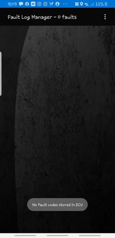

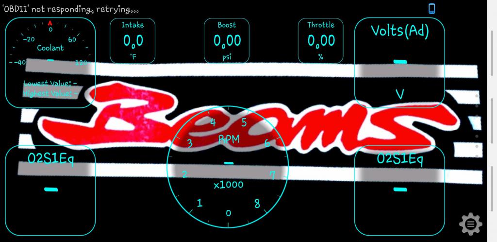

    I also purchased the torque pro app to help with diag trouble codes and vacuum loss as well as keep tabs on other important info ( voltage, coolant temp, intake air temp, o2 sensor status, RPM and trying to find a way to display oil pressure too. The swap has 0 trouble codes as of now, we will see as time passes.
