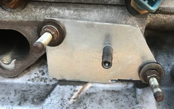

    and a quick and dirty plate i made to show my kids the valves seats leaking/lifting under pressure

    A cracked head is very common for an M42, but I don't see the normal leak spot from your pics. It is possible that it would come in through the intake tract if the throttle body heater failed in a unique way.
    It can of course be fixed, but maybe not at a sensible price point.

      good question but i have the heater plate removed and put a connection between the plastic pipe on the block to the port on the head as shown below. I'd be over the moon if its simple fix like that but for the life of me i don't see anything dumb where i have the cooling system coupled into the intake manifold. and like you say the head looks super clean with no sign of the obvious cracks between the valves and water jacket on cyls 1 or 2. i have a complete sealed engine of unknown condition, this head and also another head that needs the valves ground so i'm not sure which of the three directions to go. Probably bst to bite the bullet and get this head tested to rule it out. Will wait to see if anyone else has some ideas before pull the cams for a pressure test.
