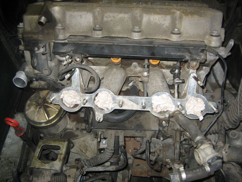

    what is this guys?
    i think this is some kind of valve. its the thing inline that runs from the brake booster to the intake manifold. what is it? in the pic its whitish..

    your check valve. dont break it. dealer doesn't carry them anymore, AT ALL. VERY hard part to come by around here. ask me how i know.

      looks like its missing the cap too.

        is it just called a check valve? what kind of check valve?

          yes a "check valve"
          be sure not to break it, the plastic will be brital from age and they cant be ordered from the dealer or any other parts vender. i ended up using a m10 check valve on my m42 because i couldnt find the right one.

            well it broke...have to have it? what exackly does it do? 1 way circulation type thing?

              if you dont have it, you dont have brakes. lol
              just find one off of a m20 or m10 is your best bet (or a M42 if you can find one), or buy a genric one that may or may not work off the interwebz.

                could that line not being hooked up cause my car to run for a minutes than stall?

                  possibly?
                  that line is under and the intake vaccum, so your car MIGHT run then cut off. if it did run, the idle would be rough, and i WOULD NOT drive it.

                    perfect. i just finsihed replaceing all the coolant and vaccum lines under the air plenum. i was very careful and took my time. i thought i missed something..and as i was finishing everything i broke that valve. heart breaking. thanks for the help. would any check valve work...there on lots of cars!

                      im not sure. i just went to a pick n pull and pocketed a m10 one because the inlet and outlet match the hose diameter.
                      let us know if you find one from another car that works. :)

                        if i grab a m10/m20 i noticed they dont have the blow off like mine. make a big difference?
