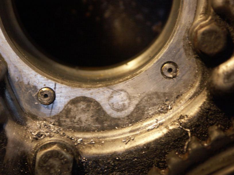

        OK, got the cams all aligned and tightened up. BTW the Master Tech at the dealer confirmed that the torque specs on the cam towers are 14 nm or 10.38 ft lbs. Everything came together well, nothing felt forced. So for future reference both cams have drilled holes on the rearmost square lobes. Those should be facing in parallel plane with the top of the piston surface, at TDC. Also the lockout on the bell housing is far easier to use to put the car at TDC than the rod method, since all my pully's are off and both timing covers, lower and upper are off as well. No reference points.
        However I did end up breaking off a bolt in the block. A stupid waterpump bolt head came right off with the stud sticking out a quarter inch. I tried vise grips but seem to be doing more damage to the bolt than anything else. Going to try to hacksaw into the head and use a flat head screwdriver tomorrow. I hope hope hope that I don't have to tap that damn thing out.
        -S

            I'm facing that very problem, but I have two bolts snapped. This is step one of my fix; blow a wicked small hole into those pricks. Then, I'll just drill and retap 6mm, praying the pilot holes are close enough through the bolt center so the new bolts run straight. I'll be doing that this weekend, will post pics if you're interested.
