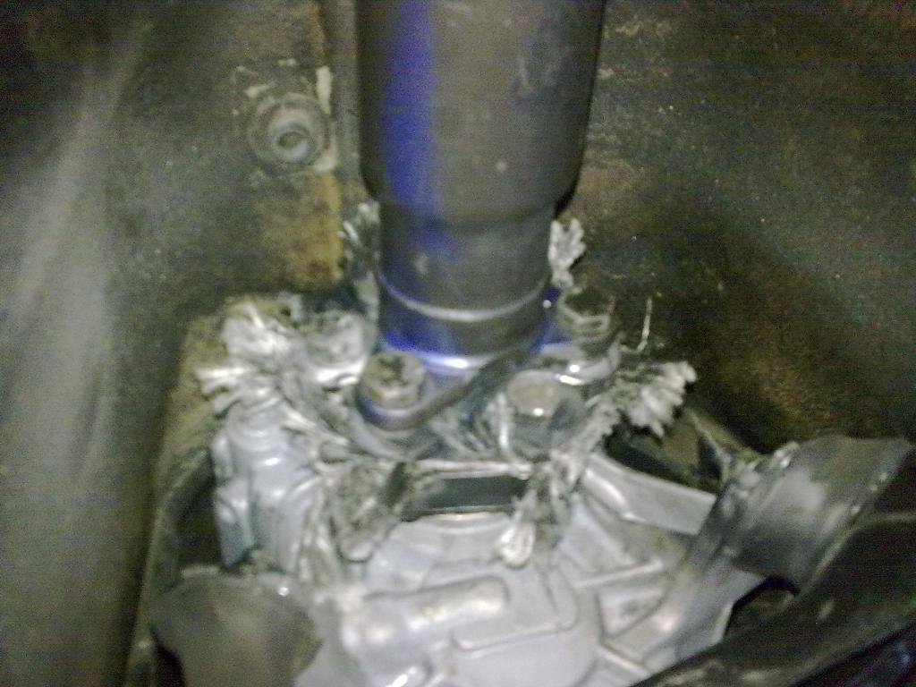

      i planned on checking it when i got home but on the way home i felt like i ran over road debris.. and my car kinda felt shaky in the drive line...
      so when i got home jacked up the car i found that my gubio EXPLODED!!!

        Oh wow LOL.
        1991 325iS turbo
          WTF happened to you guibo, cheese and crackers! be sure to change the center support bearing while your there!
            UGH.. more work... LOL :p
            New drive shaft FTW... Tee HEE
