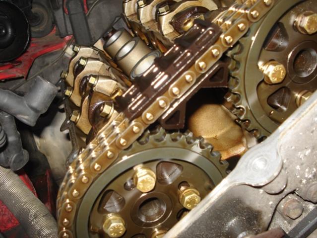

    Please help... this is the first I've cracked open my valve cover and I don't know what things are supposed to look like.
    The car has 215k miles on it. Recently, it developed the rattle at ~3k RPM common to a failing chain tensioner. I purchased and installed a new one. The sound went away... for a few thousand miles and returned. I guessed, as is discussed in this thread:
    ... that the chain/cam gears/rails were shot and the tensioner only temporarily masked the problem. This is what things looked like when I took off the valve cover:

    From what I understand, worn cam gears are generally pointy. These certainly don't look that way to me. In addition, I was under the impression that the old style guide rails that fell apart were steel. The top guide that I can see is the newer, plastic style.
    To those with a trained eye, do these gears look worn? If my assumption about the guides is right, is it fair to assume the chain/gears/guides have been replaced at some point (I've only owned the car two years)? If so, is it possible the new tensioner has failed already? Any other advice?

    Those gears don't look worn. How about the lower chain guide? Any idea what shape it's in?

            they looks great.! looks almost brand new. your guides might not be though...

              Those teeth look fine.
              Have you dropped your pan yet? If you didn't see any plastic/metal in there you should be good on the guides.

                There is also the very slight possibility that your crank gear is worn, but if that cam gears are in that good a shape I highly doubt it.

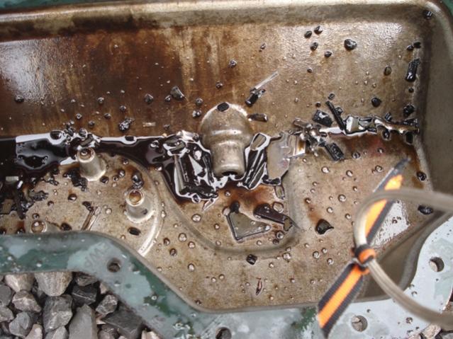

                  Thanks everyone... I suppose I'll drop the pan tonight and look for junk that doesn't belong.

                    Just FYI, lower oil pan drop results:

                    Yeah.... guess I know where to go from here. Thanks for all your responses.

                      Shitty deal right there.

                        holy shit thats bad. should be fun to take that engine apart tho. good luck. take pics!

                          Its just from his guide rails, he should be okay.
