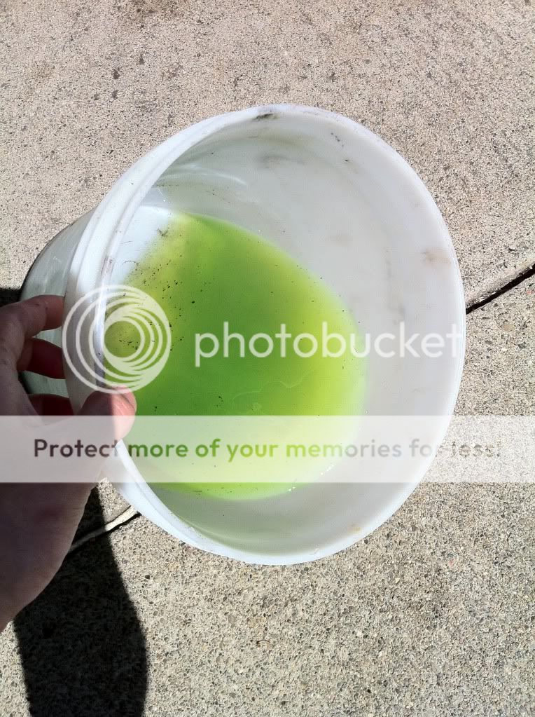

    - coolant seems clean

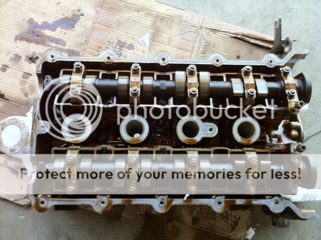

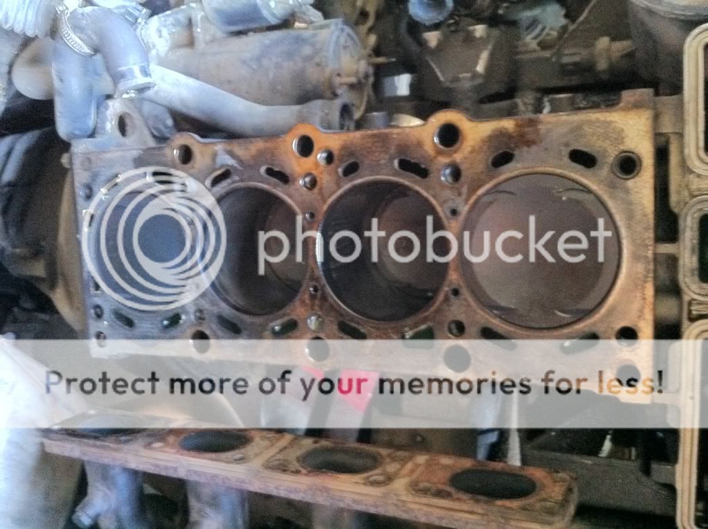

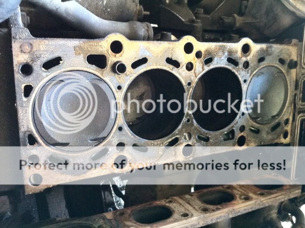

    i just assumed it had a bad gasket or a cracked head so i pulled it. tell me what you think. what can cause the bubble and pressure in the coolant system? head gasket and profile gasket look perfect. cylinder 2 exhaust port are a little opened and cylinder 3 intake port are opened. could be lifter or??
    Pretty interesting.
    The valves are open because of the cam positions. There could be issues with the gaskets between the lower timing case and block. Water is getting to the oil somehow. If there were combustion gases getting into the water system it sometimes will cause a hose to blow or split the radiator due to the added pressure. Unless it's a really small amount.

      Actually it looks like water/pressure may have been going across on 3 on the exhaust side. That may be the culprit.
      If water has made it to the oil and it's run, the rod/crank bearings have been through some hell.

            yeah it does look like 3 is leaking, those valves also have the most crap on them. can worn out piston rings be the cause of all my troubles?
              No, but the scoring on the 3 side of 2 is a good indicator of a high mileage motor.

                  thats for the advice carnurd. this bearing is the one on the oilpan side? if so there is some wear but it still has the silver coating. hard to believe at 250k+ so it might have been replaced. either way the piston still hold oil in them with slow leakage so im going to replace the head. thanks
