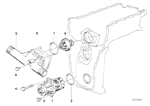

            This view may/may not come in handy for you (I personally forgot whether the o-ring went in before or after the t-stat). As previously suggested, don't use RTV!! Get the mating surfaces clean, ditch the paper housing gasket, and use a thin layer of Right Stuff.
