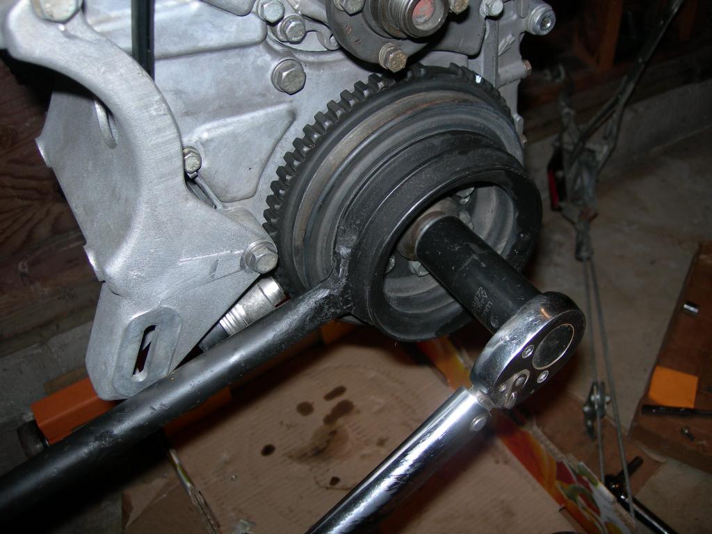

                            Here is a picture for reference showing the crank timing sprocket. Notice the locating pin on the holding tool at 3 o'clock and where the gap is.

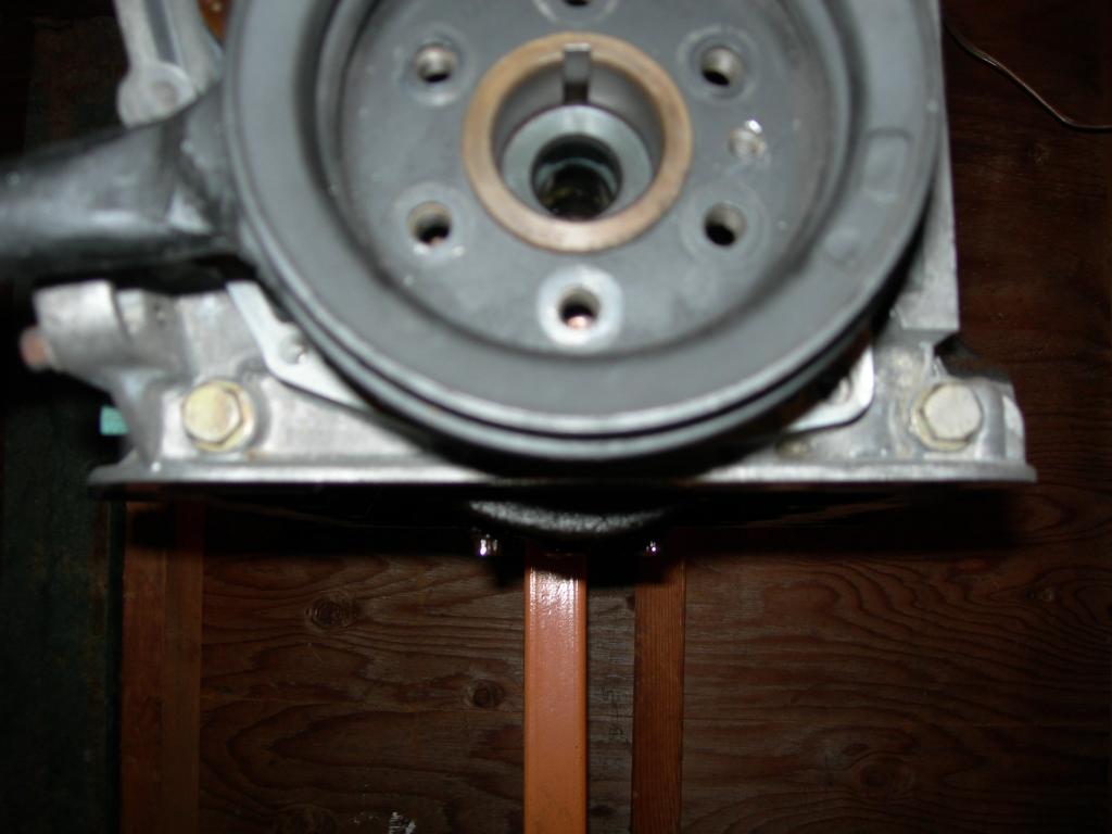

                            Second pic shows the locating pin in relation to the woodruff key at TDC.
                            Luke, don't bite my head off but you mentioned in the other thread that the plug wires were messed up. Are you sure you have the right plug wires going to the correct coils? I helped Sean when he put his COP kit on and he didn't mark the coils. It acted like it wanted to fire but we killed the battery before it actually did. He charged the battery overnight and swapped cylinders 1&2 coils and it fired right up.
