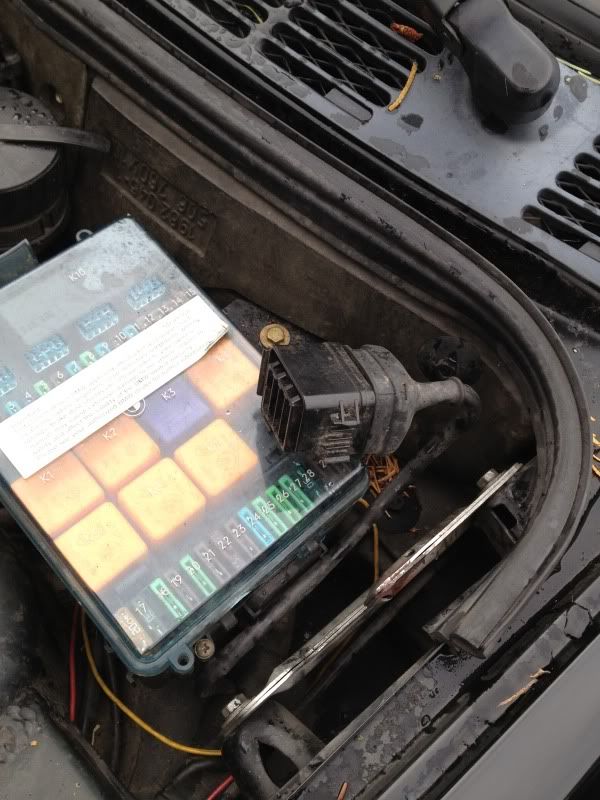

    Also curious if anyone knows what this plug is for next to the fuse box...
    I'm not amazing with cars so I'm trying to get extra help.

    Ok so your cams are fine I would not worry about that at the moment. Seems very odd that it wont start after sitting for a week. Do you have an imobaliser on the car?
