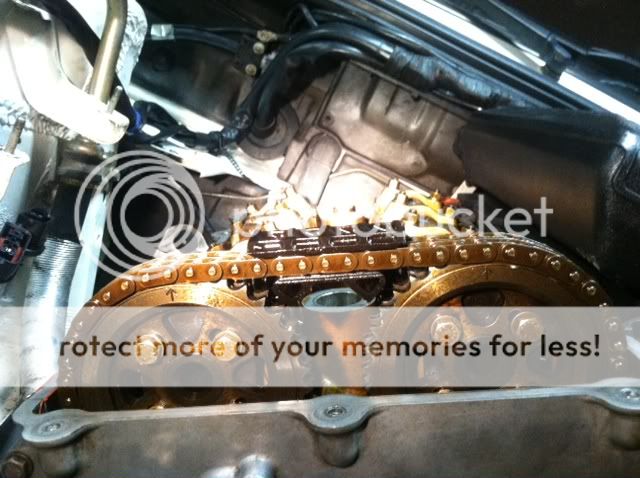

      makes no sense man. stay tuned for some pics of car in tdc. i feel like this is electrical ignition issue. may it be cam sensor or coil packs. plug wires are in order with regards to the printed label on the wire. 1 goes to cyl 1, etc. the weirdest thing with this is that before the overhaul everything ran fine apart from the chain tensioner completely dead.
      cams tdc:
      crank at tdc:
      I feel the issue may be in this general area. (it may seem obvious but they can plug to either coil. ignore their deceiving resting position.)

                              update. cyl 1 and 3 compression around 30. 2 and 4 are fine at 195
