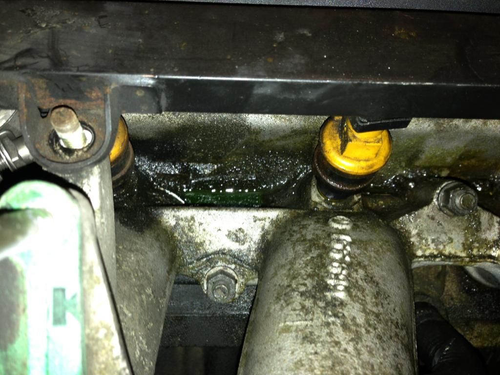

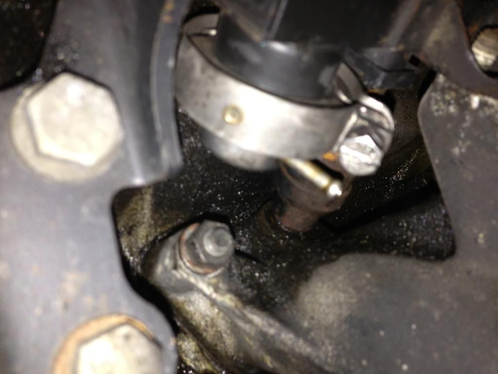

Next I decided to do the "mess under the intake" thing. My vaccum hoses where absolutely terrible. They were hardly connected to each other at all. They were all split at the ends. So after that I start her up and she seems to run fine so I go for a test drive and the idle is really rough again and it is still bogging. It doesn't seem as bad though, but its still really bad. I noticed that when I came to a stop light and was at idle for a minute the check engine light came on. I did the stomp test and got code 1222.

So since defective evaporation system and air leak are listed it makes me feel like I did the mess under the intake wrong. I've read that article and can't see what I did wrong. I do see that my car is different then others though. There is no heater plate and my throttle body does not have the line that runs to the valve cover. The intake elbow does have two connections though so I routed the valve cover to the intake elbow connection closest to the TB and the other one obviously still goes to the icv.
Ideas?
