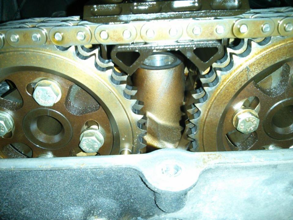

    I picked this car up back in October, and I began a slow winter rebuild of it. The plan was to do all of the suspension this winter and clean up whatever I can, and swap out the motor next year or the year after depending on how much money I have available.
    Part of the cleanup involved dealing with the mess under the intake, and I figured I'd check on the cam gears and paint the intake manny and valve cover while I'm at it. And then I saw those cam gears. Good god. This thing looks like it'll slip at any second and grenade my motor. Is there anything I could do to prolong the life of it without doing the full timing chain, guides and sprockets? It'll run me a good $500 just to get all the damn parts, plus the time it'll add to the rebuild, and I never planned on keeping the M42 to begin with. The other problem is, I sunk all of my money into suspension (control arms, m3 bushings, shocks, springs, steering rack, tie rods, etc) and I can't afford to do the 24V swap right now.
    I seriously feel like crap right now. When I got this thing, the only thing it needed was to have the e-brake fixed. After I got it home, I just started noticing stuff. PS is leaking. No biggie, I wanted to do the steering rack swap anyway. Suspension is blown. Well, I did want to upgrade that anyway. And now the motor. It's like nothing on the car is in good working shape.
    I need a band aid solution for now. Would a new tensioner prolong the life of the motor? I know it's not going to fix the problem with the cam gears looking like that, but will I be able to squeeze a year out of it while I save for a 24V swap?

    meh. in light of where your're coming from on planning to swap later on, you'll be fine with a fresh tensioner to keep you going. I wouldn't sweat it.
    I've seen worse sprockets. While not ideal, that m42 should be good for another season or two.

      What Simon said. To add, if you just want to put your mind at ease get someone to sell you a used but better than your set of cam sprockets and install. I also noticed that your sprockets are adjusted full over when they really ought to be centered on a stock engine. So, new tensioner, used sprockets, check/adjust timing and drive.
      Don't worry about the M42 being fragile, I can assure you it isn't. As long as there is no dieseling sound and you hit up the basics you can enjoy your rev happy 4 before going to some boring old 6 like it seems everyone is doing these days.

        Thanks a lot! That's all I really want, to get a chance to experience this car before I decide what direction I want to go with it.
        The engine ran fine the two times I drove it, and I picked up a new lower oilpan gasket so that I could check and tighten the oil pan bolts.
