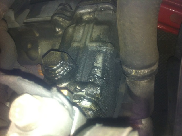

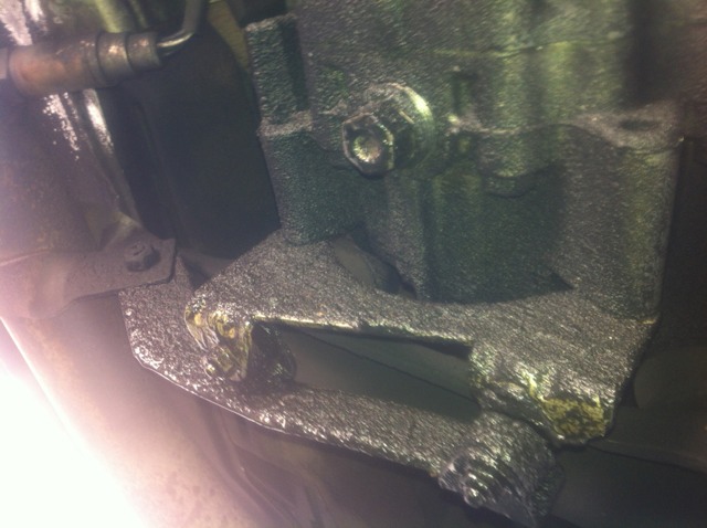

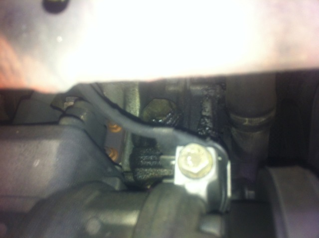

                      Some pictures of the steering rack and some leaks (seem to be all gaskets)
                      - I believe this is the P/S pressure hose where it was leaking (drivers side)

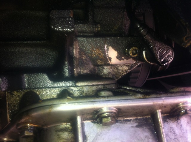

                      I need to check the steering rack boots to make sure I need another steering rack. I might not even need one.

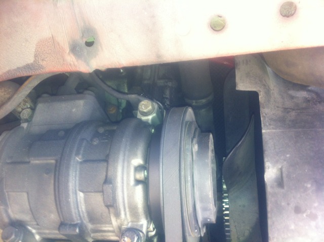

                        Those last pictures are passenger side (right) of the fan clutch and appear to have some oil dripping. I need a new set of gaskets!

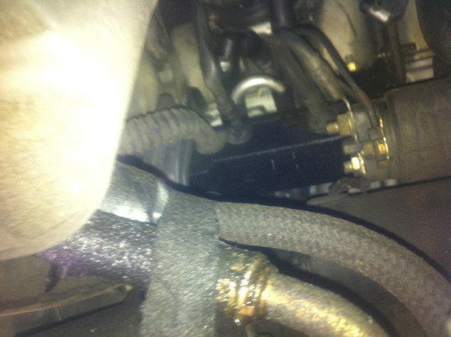

                        Now this little connector has oil running down it as well. Anyone identify this connector?

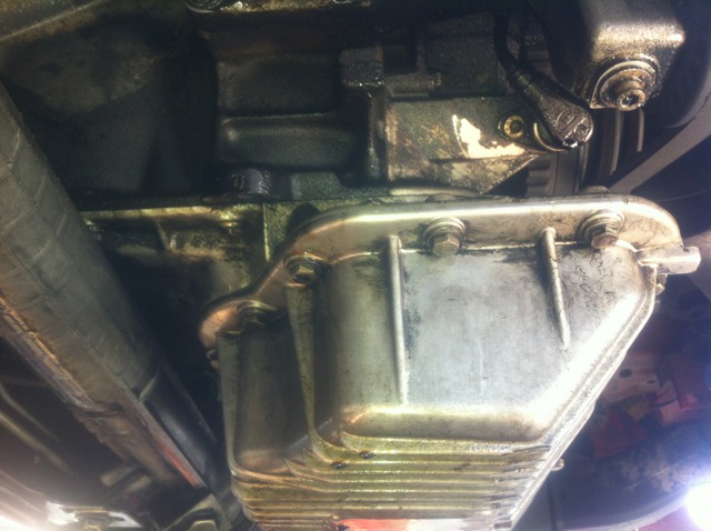

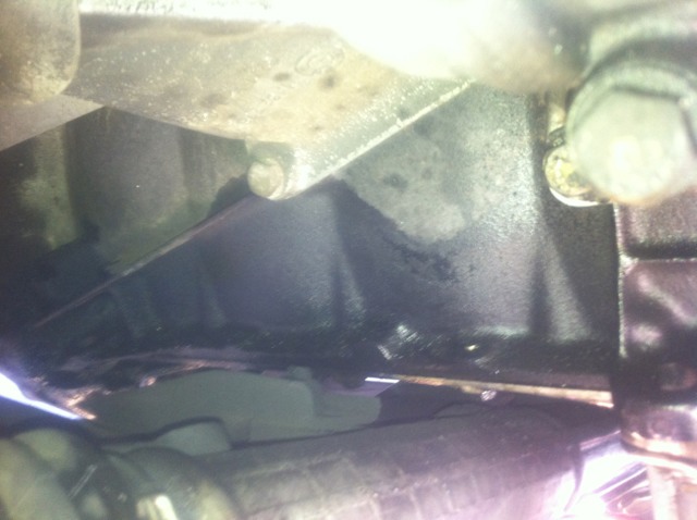

                          Oil pan gasket worn.
                          No noticeable oil loss but some leaks visible.

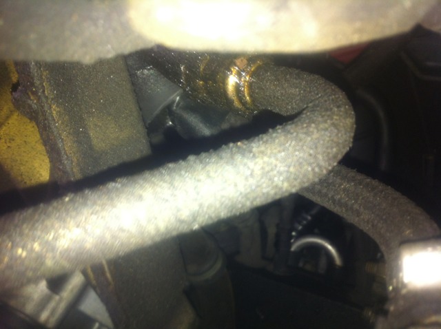

                          Also the transmission mounts have just a slight bit of oil running down. Will it be gaskets as well?
