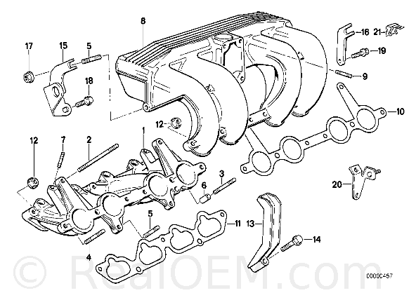

      Problem is I don't have the hardware. Im no good at understanding diagrams. So Im iffy on the bolts Im missing.

        Numbers 3 and 4 are what hold the upper intake to the lower. It's not a bolt, it is a stud and has a nut (#12).
        I would pull the manifold off and see what length the other studs are, then buy the length you need. #3 is an M7x45mm long, #4 is an M7x40mm long. Replace the gasket while you are at it.
        http://www.realoem.com/bmw/showparts...53&hg=11&fg=40

            I only had to remove the upper intake in order to replace the broken stud, and while at it removed the "mess under the intake" and heater plate, etc. I will take ur advice and look into my timing components even though the car is pretty damn quiet ever since i changed out the chain tensioner.
            Here's another thread I made when I found out the stud I needed to replace was NLA from BMW.
            I ended up finding an exact similar part with the help of another member that worked just fine.
