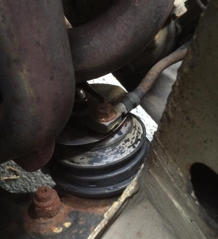

        Pass side strap
        Here is the passenger side motor mount strap. I was mistaken, it doesn't use the mount nut but uses the mount bracket with a dedicated stud just for the strap. Either this is the correct ground location for the m42, or someone swapped the mount bracket from some other car..

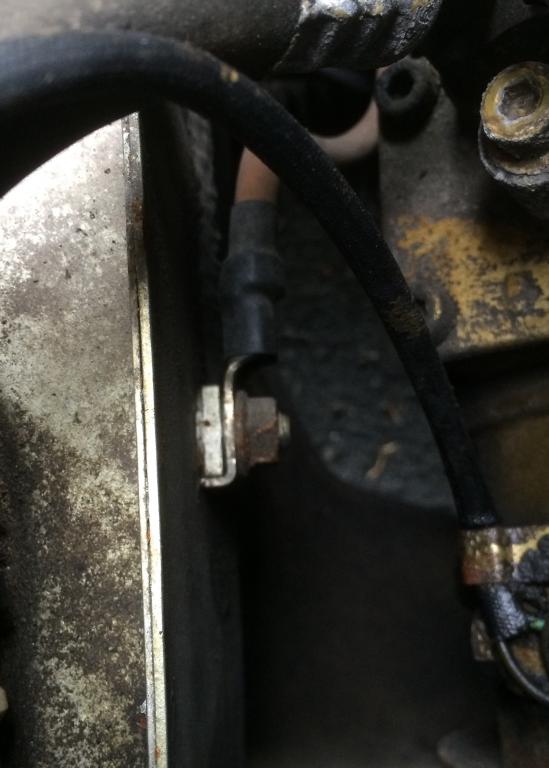

          The other end attached to the chassis near the inner fender.

            That is right for a m42 car.

                I am going to go through all the grounds, but I am having a hard time finding any others besides the one pictured above. I still need to check the underside but I would have thought the driver side would have had a pretty obvious ground at the starter as has been described in other threads.
                Since I did not disconnect the strap shown above while lifting the motor for clearance for the new mount, there is a chance that I put tension on it and caused some damage under the plastic coating.
                I also noticed the strap coating was cracked, brittle and starting to flake off near the end at the mount bracket. The copper inside is green and getting nasty.
                I'll replace that for sure and dig deeper to find other grounds.
                Thanks !

                  So after some digging it appears there is no ground that runs directly from starter to chassis, but one that is routed in a sleeve as part of a harness, and looks in good shape.
                  After fiddling with the passenger side motor/chassis strap, I was able to get the car to start several times, although it wasn't very strong.
                  I'm having some custom cables made up (OEM prices are stupid) and will add an extra one somewhere since I only see one ground between the block and chassis.

                      It appears the ground strap was weak enough that when I lifted the motor it moved it just enough to lose continuity.

                          So I replaced the passenger side strap and short alternator strap. I also added an extra strap between the upper bolt on the driver side motor mount at the block, grounded to the chassis via one of the charcoal canister bracket bolts. This doesn't appear to be the best ground as there isn't much bare metal but it's better than only having the one strap. And there really isn't any obvious ground point on the driver side engine bay, aside from drilling a hole and making one.(which I may do at some point)
                          I also unbolted 3 other ground bolts/nuts around the engine bay and scrubbed them with sand paper.
                          The car is now holding charge after about two days (so far), starts and runs great again!
