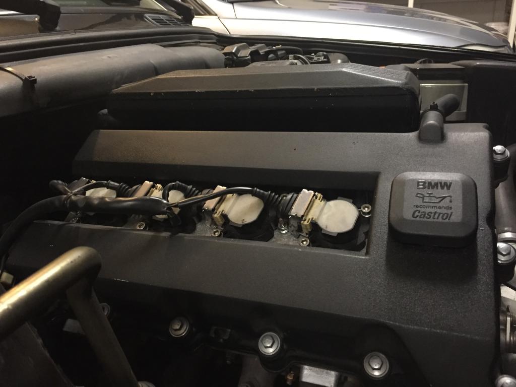

          So if you look at the top left of the vc you can see a bit of oil above the coil, along with a weep under the cap.

            I do not see a good way, other than the oil cap, for oil to get on top of the VC without another oil leak present. However, I would encourage you to look again and see if oil could be leaking towards the fan and then getting distributed upwards. Are there oil deposits on the hood insulation or cover?
            Does your COP kit have the proper spacers to ensure that the middle two bolts on the VC are actually engaged and pushing the cover down?
            M42s only have an oil separator built in to the valve cover on the intake side. There's no PCV valve to contend with here. Condensation could be climate or a coolant leak in to a combustion chamber only when cold, which is unlikely. Again, a leak down test would be the only way to determine where you might have an oil leak in to the combustion chamber.
