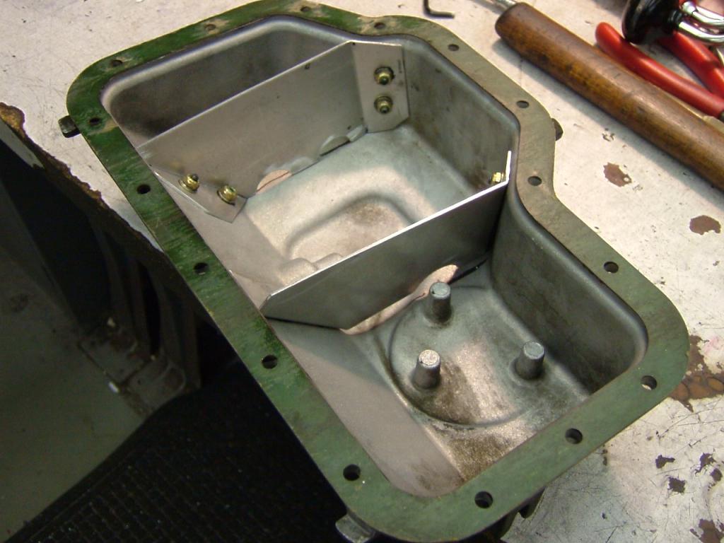

                  blue smoke
                  Ya need this in the corners ..... harr harr
                  Guy who did my engine hooked me up !!!
