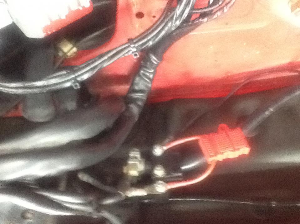

    Check your inline fuse off the battery. Could have blown for whatever reason. I can also sell you some wires and coils from my e30s m42 for cheap if you'd like to try them.

      the fusible link? I didn't think there was a fuse on the main power cable?
        Yeah the fuseable link on that smaller line. If it's bad your car won't start.

          damnit, I never even thought to check something so simple. I'll report back tomorrow

            You can use a jumper wire under the hood at the power block. That's what happened to me

                  I didn't see any damage to the wrap around the fusible link, thats not saying much, maybe I'll just jump the two terminals like you did, that way it'll eliminate one more thing without throwing parts at it.
