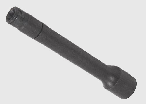

I seem to remember that there is very little space in order to get an E-torx socket down in there.
Do I need this special tool to remove head bolts?

Are they E12 bolt heads? If not, no.
BTW, Pelican Parts is saying it works on:
M42, M43, M44, M50, M60, M62
No mention of M20, but they might be thinking of the original bolts that came on those engines.
Update: RealOEM says they're Torx bolts NOT E-Torx on the M20.Comment
Update:
I received the ZDMAK version of the above tool. It worked well except for one issue...
There is a sleeve that wraps around the end that holds a ball bearing. This ball bearing is supposed to help grip the head of the bolt so it makes it easier to put the bolts in/out. Well, it didn't work at all. The bolts would fall out of the end when removing. Luckily I was able to use a magent to retrieve the bolts.
And the other thing that could be a big problem: BE CAREFUL upon insertion/removal of the tool from down within the head. It's a tight squeeze even with the tool. I caught the sleeve on the edge of the valve assembly and the damn sleeve popped off, almost dropping the ball bearing down into the oil galley. Luckily, it fell and got caught up in the residual oil next to the galley hole.
Word to the wise: Rip off the sleeve and remove the ball bearing before using this tool.Comment
