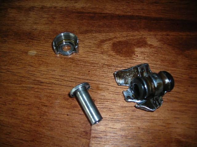

Chain's tight, cams don't spin.
  • Lair
    • Apr 2006
    • 1553
    Is the crank broken, or just the crank timing gear?
    I found these pieces behind the upper chain case cover:

    I'm not quite sure what you mean. I believe all 3 of those parts make up the upper part of the chain guide on the driver's side of the engine. The crank doesn't have a timing gear, the only gears are the 2 cam gears, the idler, and the crank gears.

      either way, you need to look for another engine
        WTF? :rofl: The gear on the crank has a timing chain wrapped around it, so that makes it a timing gear on the crank.
        The parts did come from the chain guide.

          A large slice of the chain guide got jammed between the crank gear & the chain, and broke the chain.
          This has been a learning experience.
