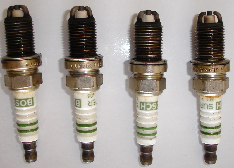

                        • Jordan
                          • 12907
                          This morning I popped the plugs out again to check their condition once more. They look pretty much the same as they did last time I checked, which is good.. because to me they look good.
                          While I was there I did a compression check. Results are as follows:
                          Cylinder 1: 201psi
                          Cylinder 2: 195psi
                          Cylinder 3: 209psi
                          Cylinder 4: 195psi
                          All in all pretty good looking numbers, within a reasonable range. I was actually surprised at how well it did.

                          • browntown
                            • Jun 2004
                            • 3524
                            I'm just guessing at this point because it looks like you have a good motor. Have you swapped oxygen sensors with a known good one? I know they're blamed for everything, but just a guess.
                            • fretburnr
                              • Jan 2005
                              • 1496
                              Those plugs look fine to me.

                              • Jordan
                                • 12907
                                But if you are right the engine would be running very rich at idle would it not? best I can tell its not as the plugs always come out clean and dry, and the exhaust does not smell like unburned fuel.
                                Rich running conditions make for wet, sooty plugs.
