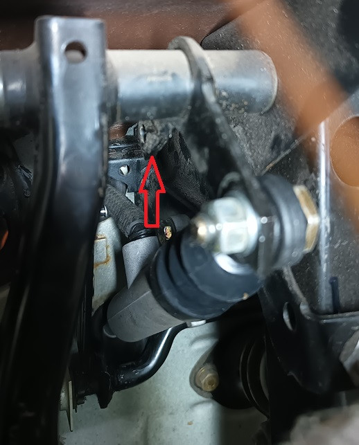

    Clutch pedal retaining spring
    Anyone has a picture about the clutch pedal retaining spring location? The other end connects of course to the clutch pedal itself, but where the other end is connected? I think my car did not have it at all, but I might install it. Just got the clucth bleeded and the feel is pretty ok and the pedal returns well, but anyway the spring would be nice to have.

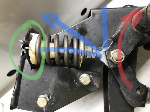

    Not sure if this is the one you are asking about, but the pic is the clutch “ helper” spring assembly.

    • MikkoR
      • Feb 2024
      • 16
      A bit bad picture, but in my case the lever is pointing pretty much straight forward, so a spring like in the previous post won't work. Maybe I just leave it that way.
