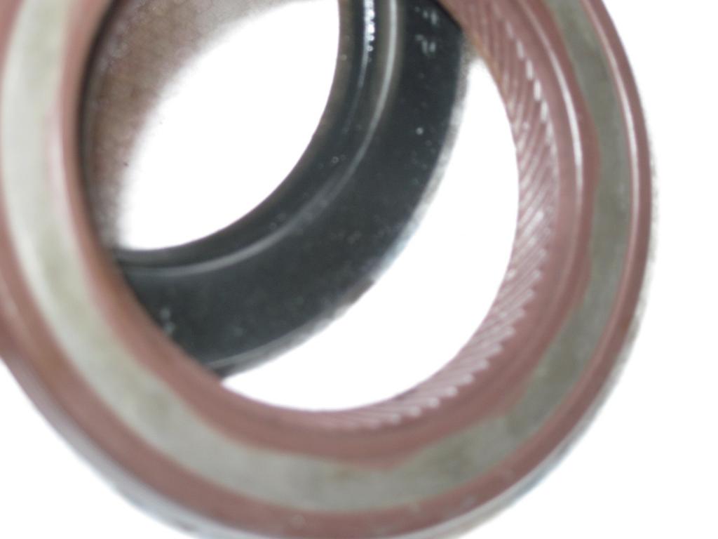

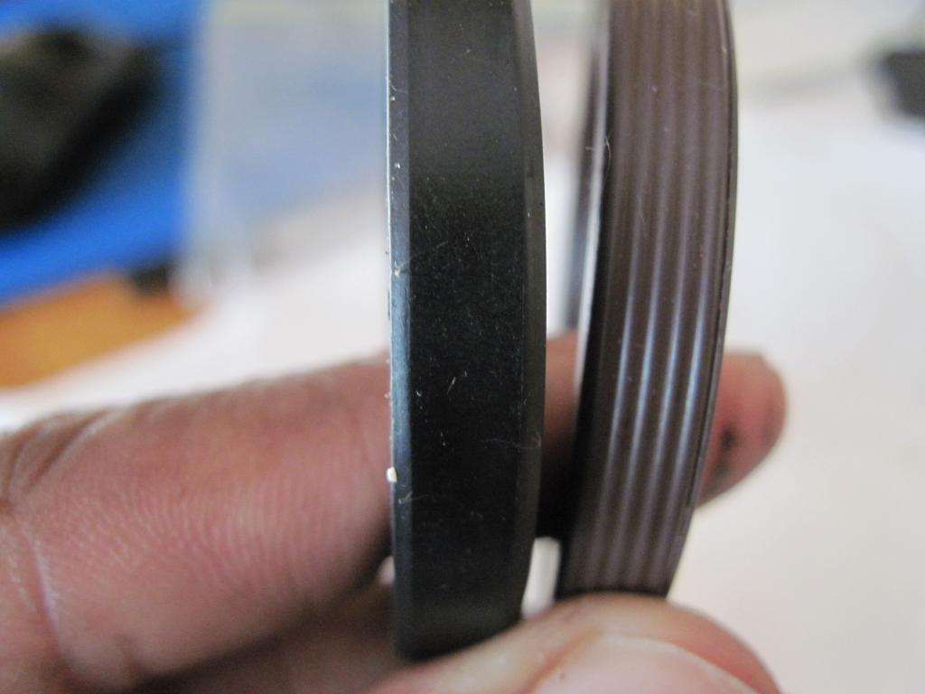

              just thought I'd put this out there...couple of years ago I rebuilt the engine of my vert and during this rebuild I changed my clutch and surrounding parts including the input shaft seal. Make a long story short...11K miles later my tranny leaks oil. Pulled the tranny a few days ago and the leak is from around the input shaft seal. And this is why. The aftermarket input shaft seal has the same dimensions as the dealer part but is different. Around the inside and outside of the aftermarket seal there are no hash marks to help prevent oil leakage.
              So word to the wise...if you're replacing your input shaft seal get the dealer part. IMHO
