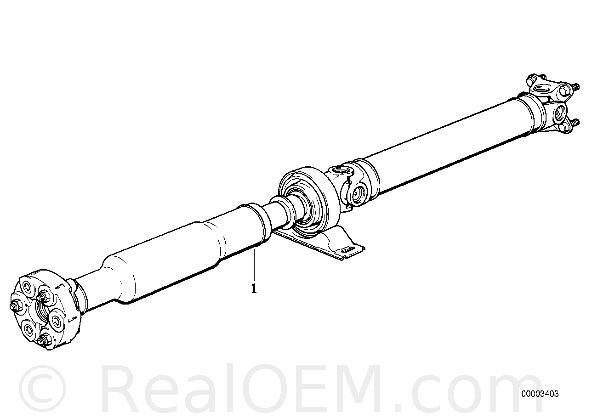

    Yesterday, I was talking with a friend about how the E-30 drive shaft kinda sucks because it's such a pain in the ass to disconnect (exhaust, shields, CSB, guibo, etc.) where as on other cars you can just unbolt the flange that connects the drive shaft with the diff and be done with it. Not an option on these cars though because the rear flange uses studs.
    Has anyone ever done (or considered) replacing the studs with bolts?
    Another idea that was tossed around was knocking out the rear U-joint and replacing it with a replaceable/greaseable one and a different flange that was more suited (beefier?) to bolts than studs.
    Thoughts? Obvious shit I'm overlooking?

                Definitely agree that the two minutes an hour is way better than pulling the driveshaft. I wound up getting a flatbed for this tow, but I'm still going to be towing to other tracks in the future. Tow dolly would still be a first choice.
                There are a few driveshaft shops that work with BMWs around me. I'm eventually going to get two differentials rebuilt (E30s with good bearings in the diff just aren't around anymore) and might see what their thoughts on a stud to bolt swap are.

                  I used allen head bolts on the kids car when his new drive shaft came without the studs. I had to partially grind the head to make it fit but it worked. I don't think your idea will work because the drive shaft has a cup in the end that fits into a recess on the diff input shaft. Thus you would have to loosen the collar nut on the drive shaft each time you wanted to unhook it.
