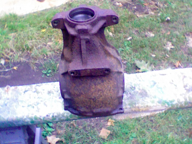

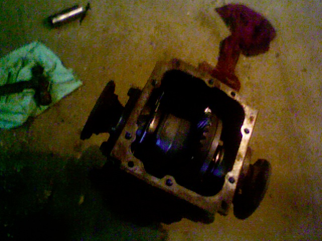

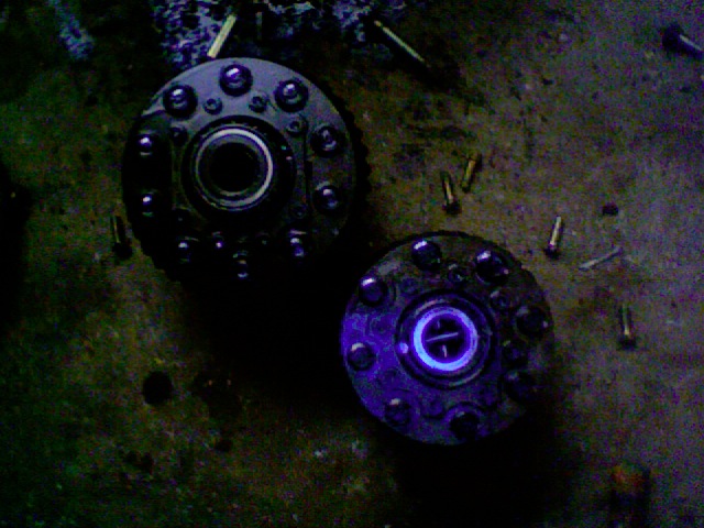

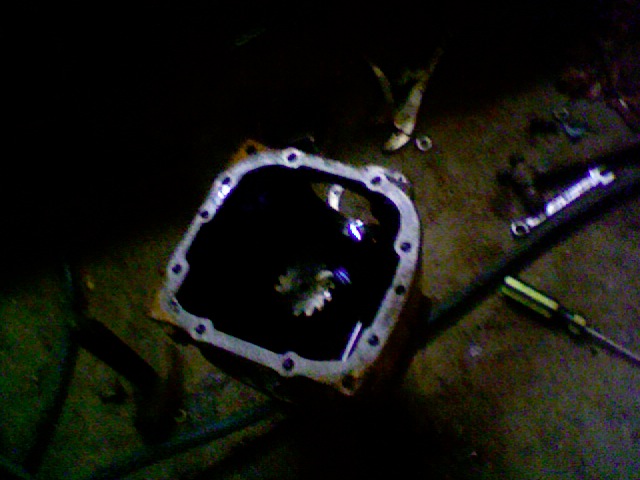

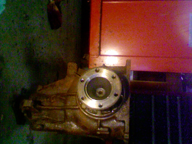

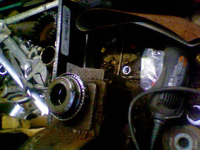

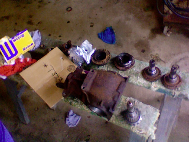

    Well it is now a rebuild, I tore down both of my LSD rearends. There is an issue, the small case 3.46 has a broken bearing flange. I think it can be welded or replaced with a new one. It is held on with allen head bolts around 10-12ish. The bearing goes over the flange to hold it there when installing the gearing into the case.
    Does anyone know where I can buy new gearing parts?
    One other question, I thought the 3.46 LSD I have is a med case. Thing is that I have another one, it is larger and it is also an LSD. The covers that the spindles go through for the wheels is held on by 4 bolts(small) and the larger one is held on by 6 bolts. What size cases do I have?
    The larger case came from a 1987 325e sedan that FrankM on r3v owned locally. I know it is not stock, not sure if he put it in.
    Here is pictures:
    First two are of the smaller case
    3rd is of the gearing removed, small case and larger one(see on the front of the gearing how there is bolts all around? that is where the flange broke off. It can be removed but I don't know where to get another)
    4th is of the broken flange(the broken edges seal TIGHT and cannot be told other wise)
    5th is of the larger case
    So in the end should I just use the larger case? I would guess that it is stronger, but I will figure out the ratio soon and make up my mind about it. The small case is fine just that broken flange, maybe I can source a new piece for it.
