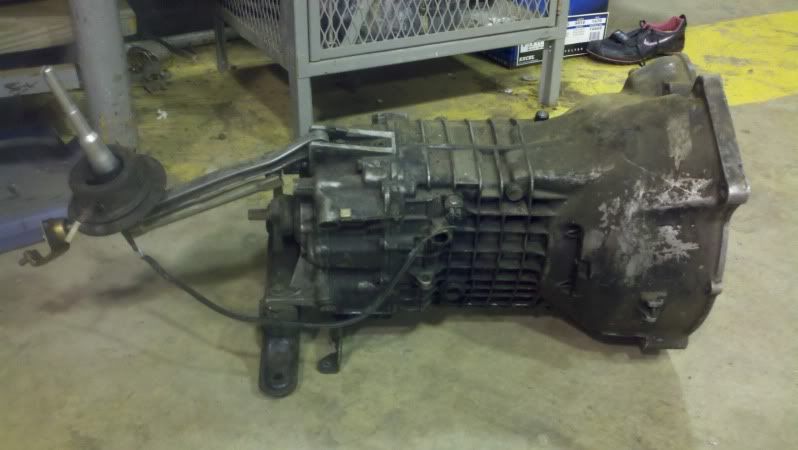

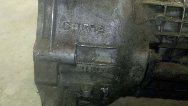

                pics of my tranny
                this one work with my eta?

                    updated info two posts up. trying to figure out if this tranny will work with my car and if the output of the tranny is indicative of a particular driveshaft I need to look for

                            Originally posted by imprttuner88
                            pics of my tranny
                            I don't see holes for reference sensors.
