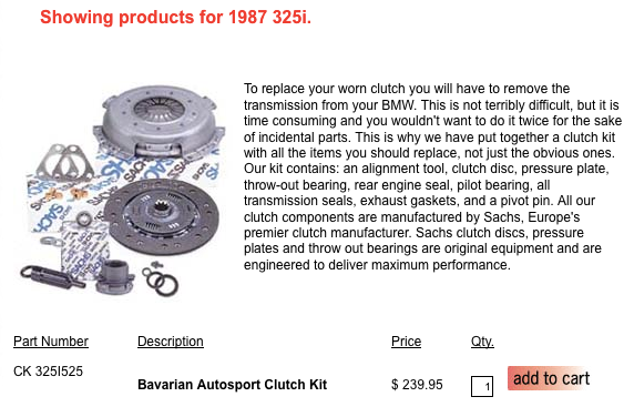

    Here is the Bavauto.com ones:
    Same car, just wondering if the $100 price difference is worth getting all the extra bits and replacing them as well.

    The extra parts are highly desirable and most are are necessary. So the extral $100 will be money well spent.

      Ok great, but the parts I have shown are all the right parts?
      REMEMBER: Be safe and have fun is Rule Number 1.
      The Epic Unbuild of Clint Eastwood
        Yes

              And that's the best price I've seen for such a complete kit. Thanks for the link. You definitely need everything in that kit. My regret the last time I did tranny work was not putting in a fresh shifter/output seals. Also check your trans mounts and if they look like they're falling apart change em.
