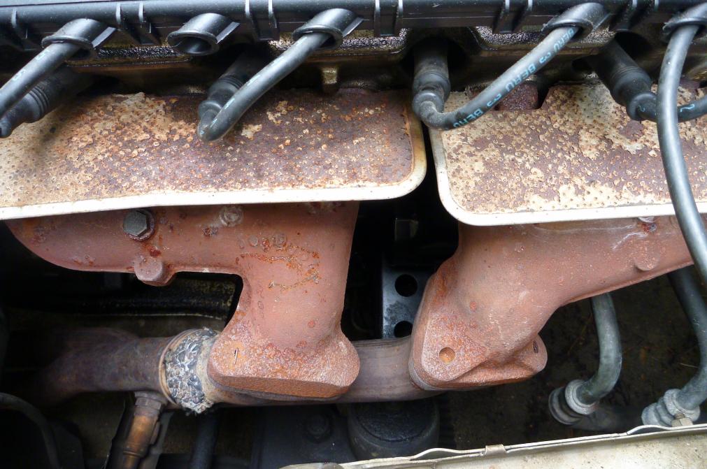

It seems that for ease I should just remove it (exhaust) and I believe that the stock exhaust has a flange connection just below the manifold/s. Mine however appears to be welded there. Everything beyong seems intact. I also understand this car is supposed to have a single cast manifold and it does appear to have two cast pieces, furthermore, if it is two, am I losing performance, I read the the single cast is a better option.
