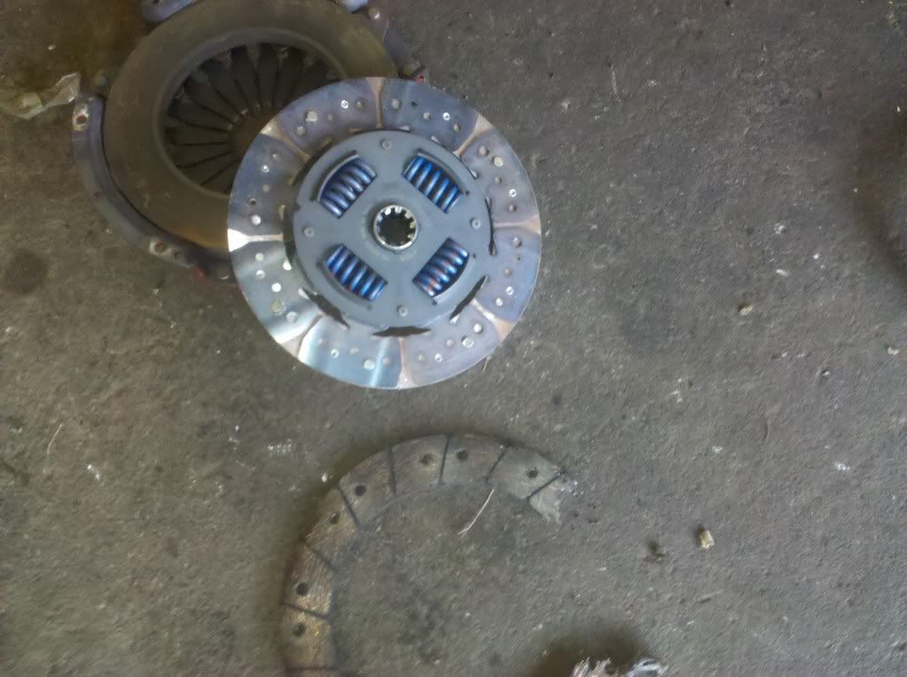

                        **UPDATE**
                        Pulled the trans today and found this:
                        1100miles on it :(
                        -Greg

                        • LJ851
                          • 7919
                          What a piece of shit. That sucks!

                            Sooo would you recommend against the southbend stage 3 kit then? Or do you think you didn't give t enough miles to break it in?
